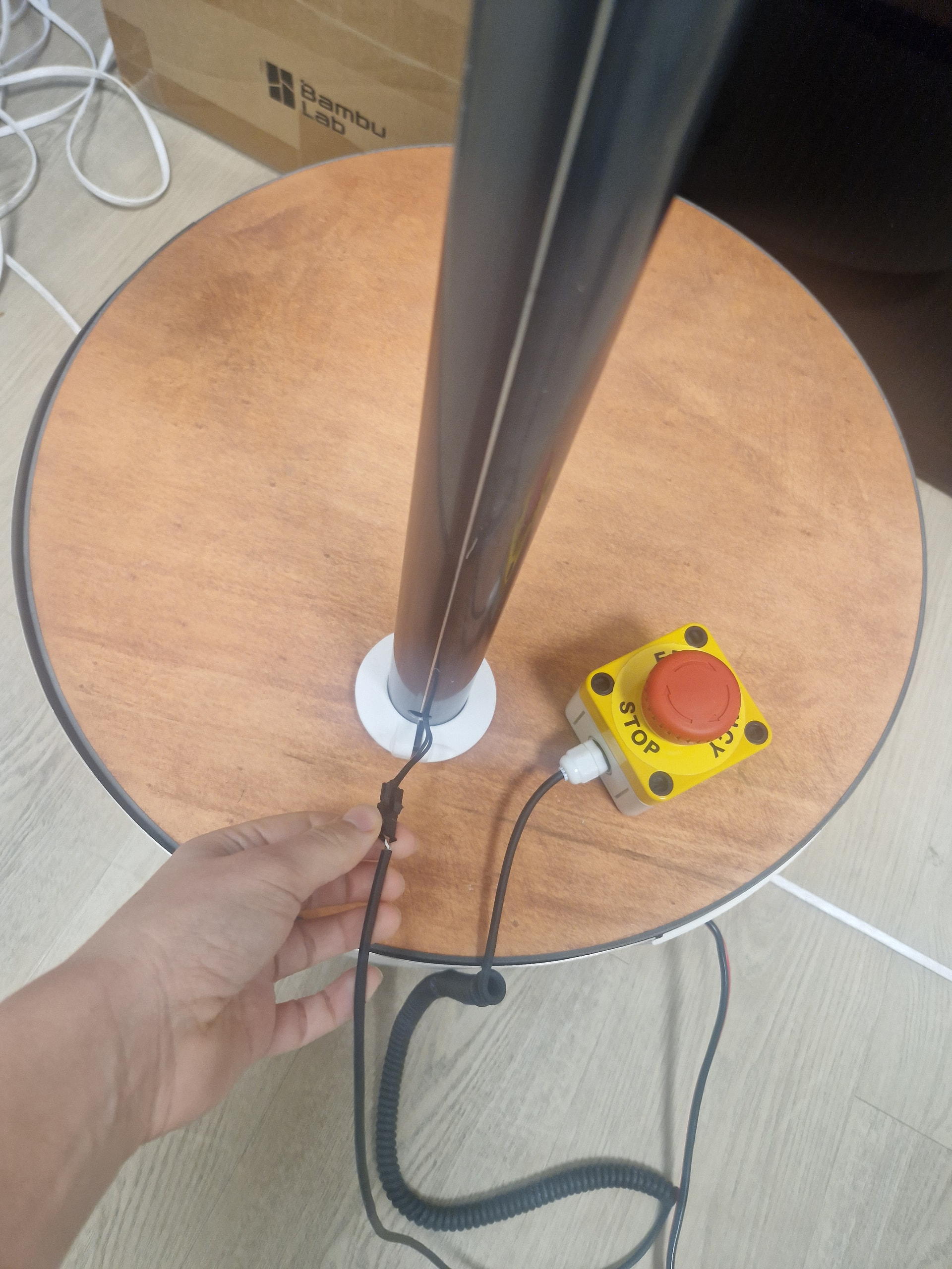

  • Can you try jiggling the connection of the emergency stop button and the cables (see photo), and check that the button isn’t turning blue intermittently? It could be a loose connection.
