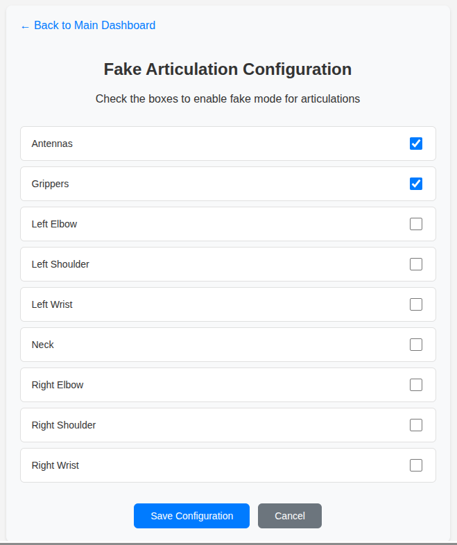

It seems like the grippers and/or antennas are not detected correctly.

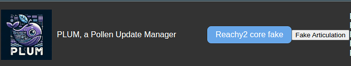

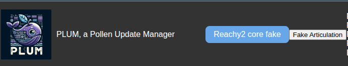

You could try to start the core with the antennas and grippers in fake mode to see if this is the problem! To do so:

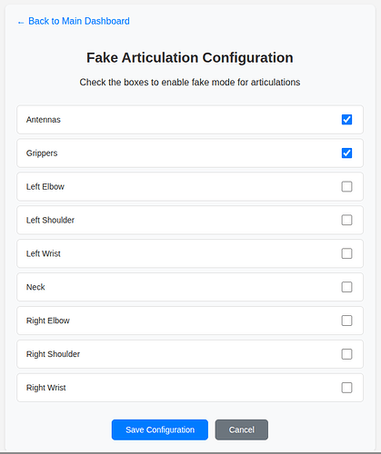

  1. Access the page <your-robot-ip>:5000, and click on Fake Articulation.
  1. Select the grippers and antennas, then Save Configuration.
  1. Eventually restart reachy2-core.
If the core starts while the grippers and antennas are in fake mode, then you should check the connections to these elements in the torso (blue lights when it is correctly initialized, remains red if not):
If everything seems to be correctly plugged, maybe you could try to apply the udev rules again.

Thank you for the tip! We just tested the “Fake Articulation” mode as you suggested, and you were right.
When we set both the antennas and the grippers to fake mode, the core starts perfectly. We also tried alternating them (one in fake mode, the other in normal mode) to see if only one was causing the issue, but the core failed to start in both scenarios. This confirms that both the grippers and the antennas are failing to connect.
Additionally, while the core is running in fake mode, we checked the LEDs and they remain solid red.

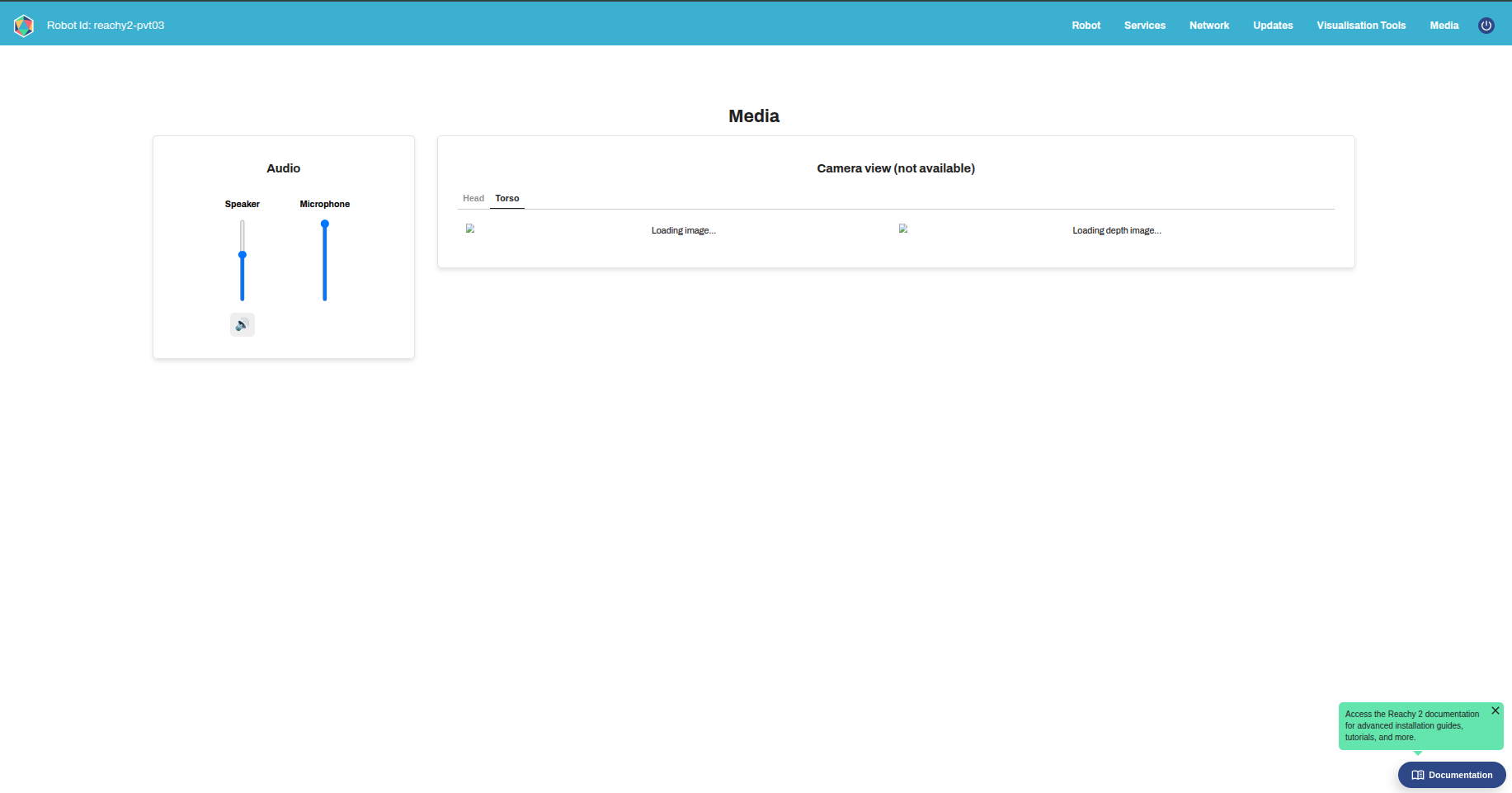

However, I noticed something else on the dashboard that might help pinpoint the exact issue: the standard cameras are working perfectly and showing the video feed, but the depth camera is not outputting anything at all.
Could this be related? Since the depth camera, grippers, and antennas are all failing simultaneously, is there a specific USB hub, shared cable, or power line connecting these components that we might have accidentally loosened during the Bedrock replacement?
A picture or a quick description of the layout would be incredibly helpful so we know exactly where to look inside the shell.
Thanks in advance, Álvaro
Hi @alvaro_solana,
Thanks for those details. For the dashboard, this is not related, it’s a known issue of the dashboard, you should be able to see the stream from the torso camera with the SDK Client.

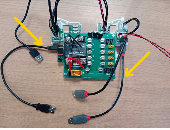

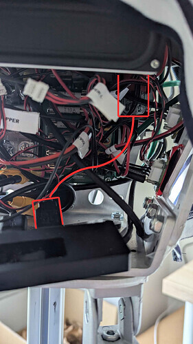

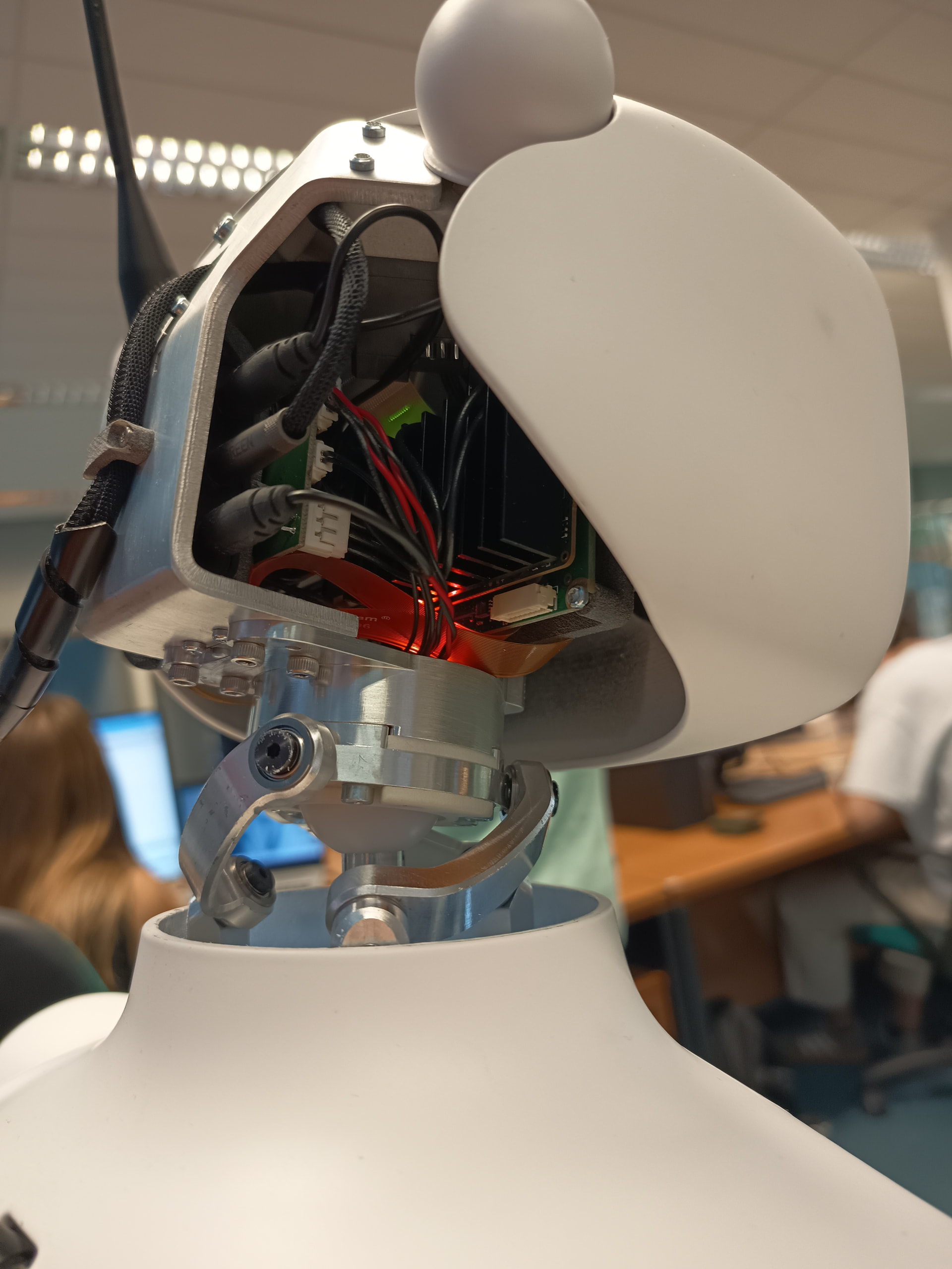

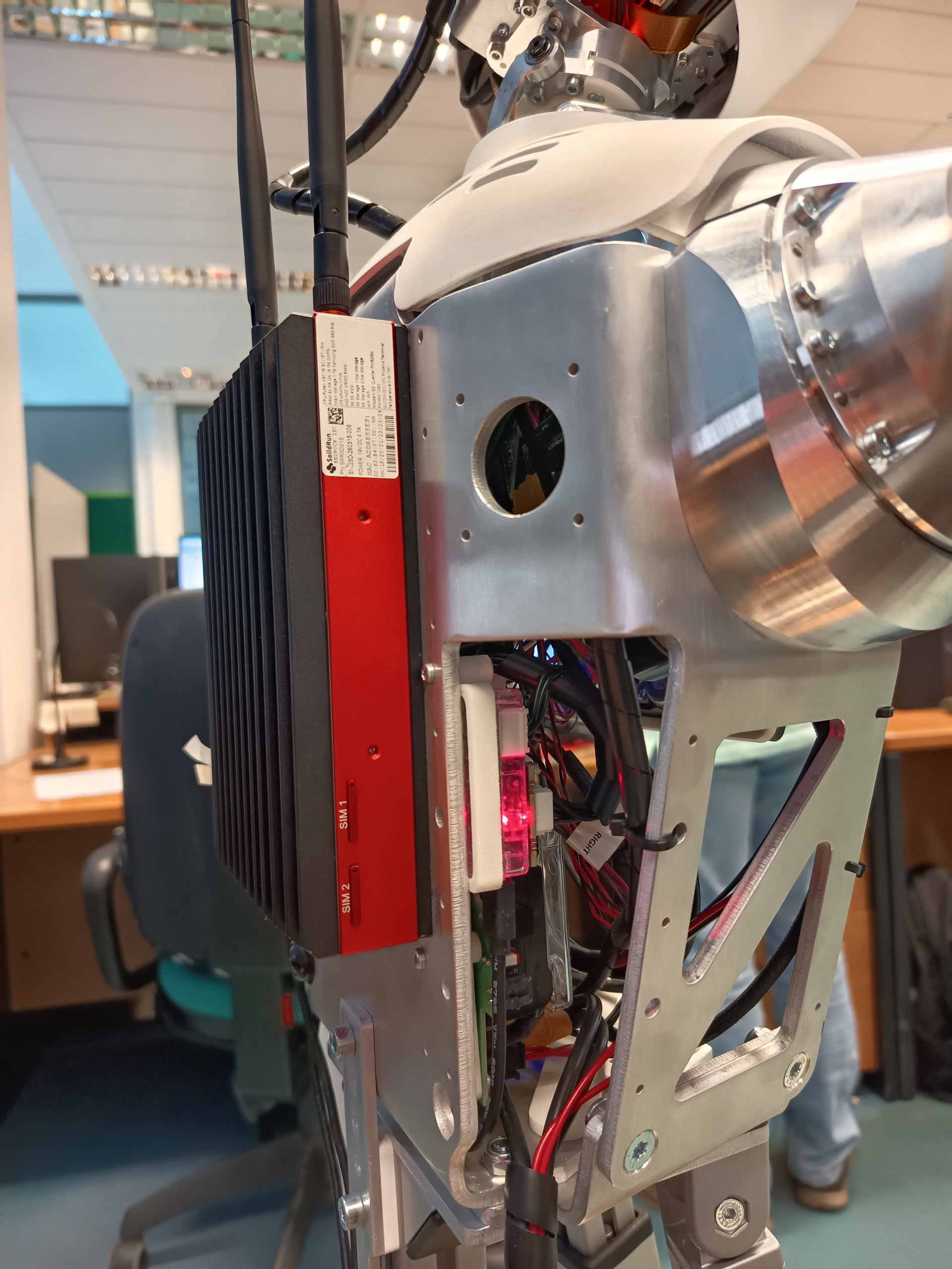

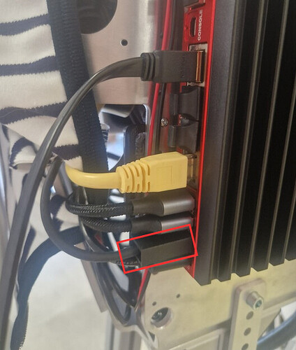

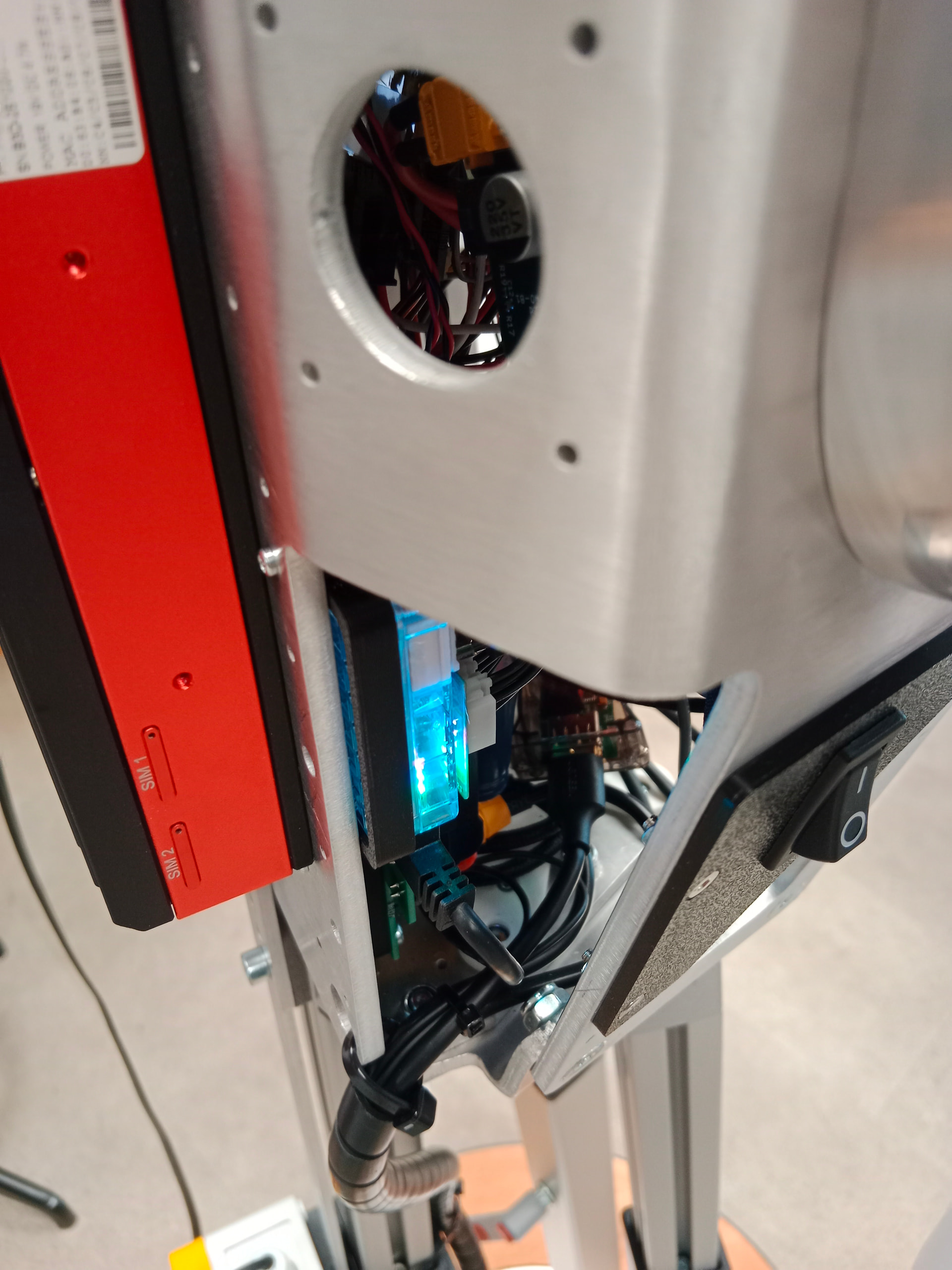

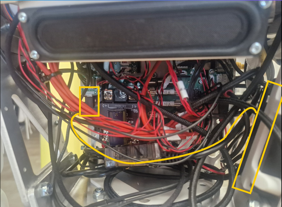

You should check the cables of the antennas and the grippers. Each one starts from a U2D2, and is connected to the torso USB hub, then the hub is connected to the third USB port of the bedrock. (see the attached photos)
USB of the grippers to the hub:
USB of the antennas to the hub:
Hub to the bedrock:
There you can see a photo of the structure alone :

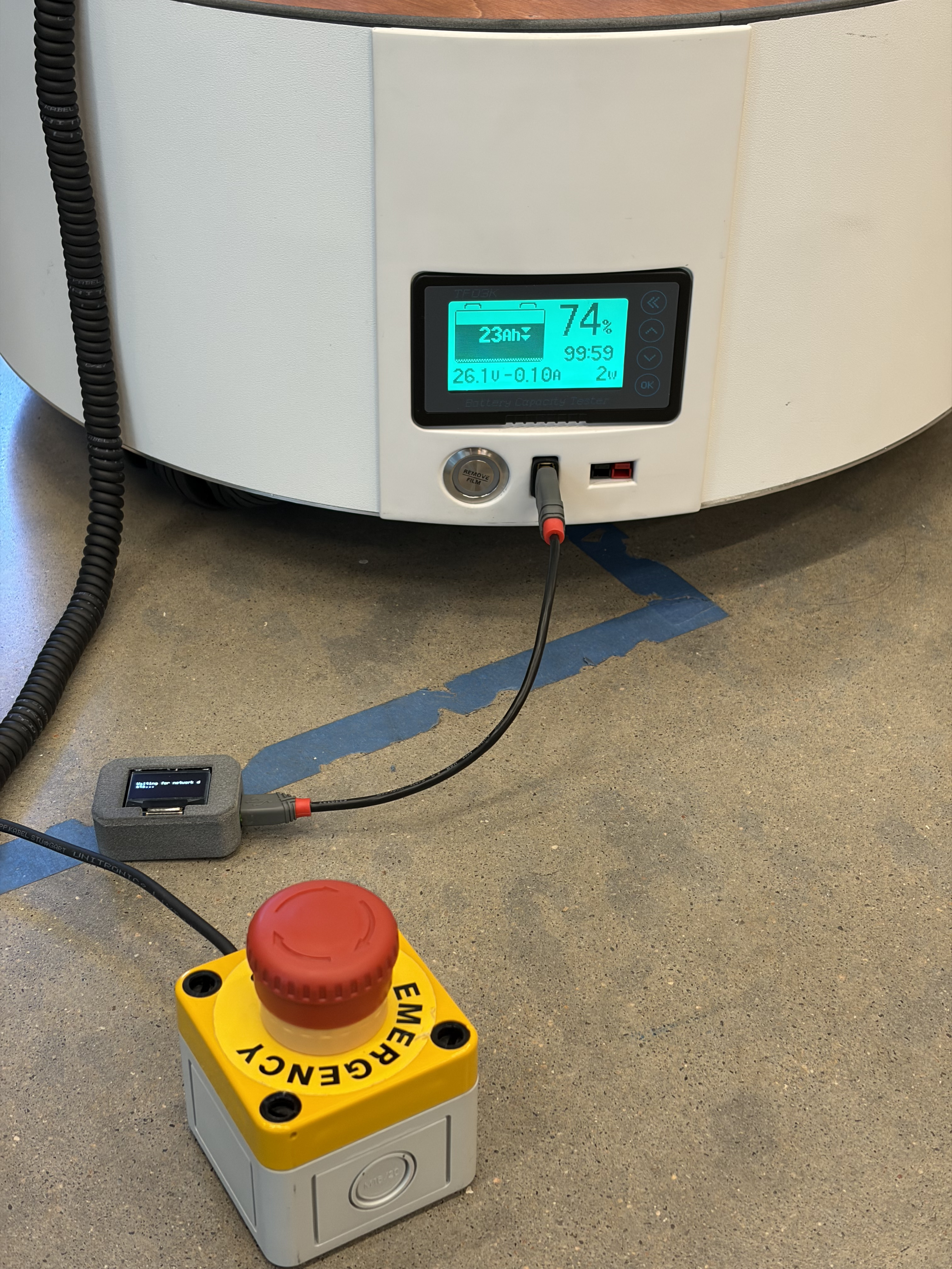

- When you start the robot, do the robot’s motors move slightly after you disengage the emergency stop button?

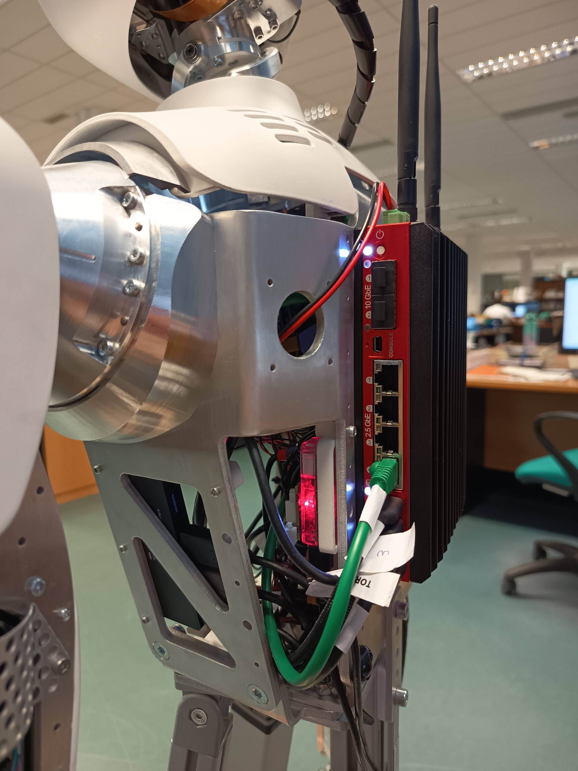

- Once the emergency stop button is disengaged, does the LED of the mobile base button turn blue? It should look like:
Hi @Gaelle ,

  • After disengaging the e-stop, the arms do not move.
  • The mobile base LED does not turn blue after disengaging the e-stop.
This behavior is intermittent — at one point the arms did move and the LED did turn blue, but after powering off overnight, we haven’t been able to reproduce that state since.

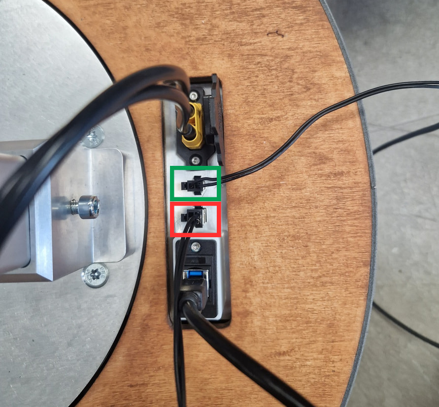

Hi @vicious26,
It seems to be a connection issue. It could be caused by two separate cables at the mobile base. Could you try wiggling the cables a little at the green connector (the cable from the emergency button) and then at the red connector (the cable from the torso) to see if the blue LED on the mobile base lights up and if the calibration starts ?

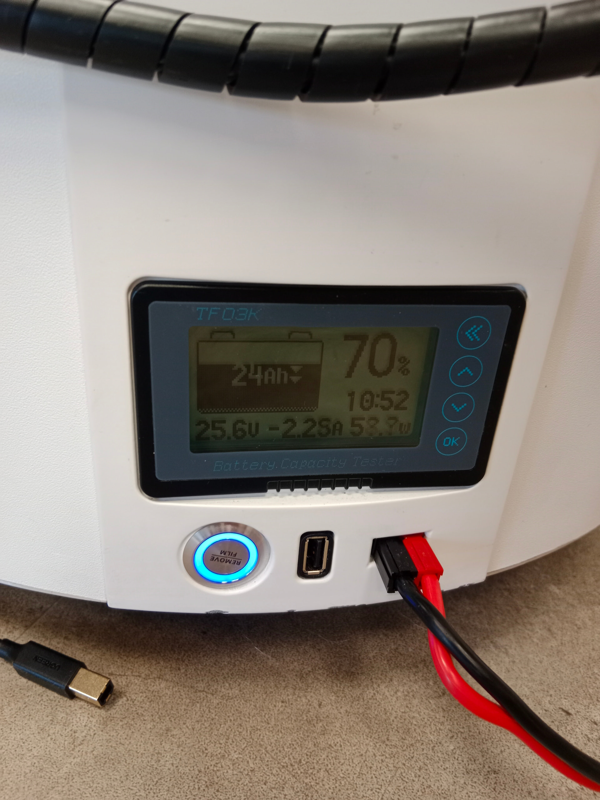

Edit - Upon further troubleshooting, we think it is this connection from the battery that is causing the problem (we are able to see the blue light intermittently when the base component lights up as well) but unsure how to proceed further to fix the root cause (if that’s the case). Please advise
