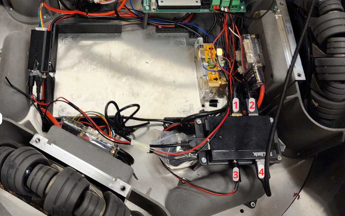

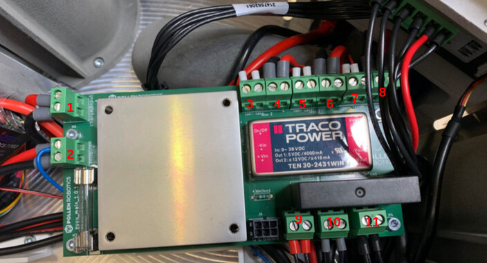

Hi @jyau,
Thanks for your detailed feedback. Could you please measure the voltage between the + and - terminals of parts n°1, 2 and 10 (see image)?
You should get 26V on n°1 and 2, and 5V on n°10.
In the meantime, you can continue to use your robot by deactivating the mobile base. To do this, you have to modify the configuration file.

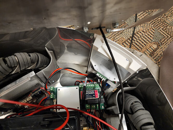

Hi Claire,
Thank you for the reply! We checked n1, 2, and 10 and yes for n1 and n2 we get 27V and for n10 we got 5V. Would you have other suggestions on places to look?

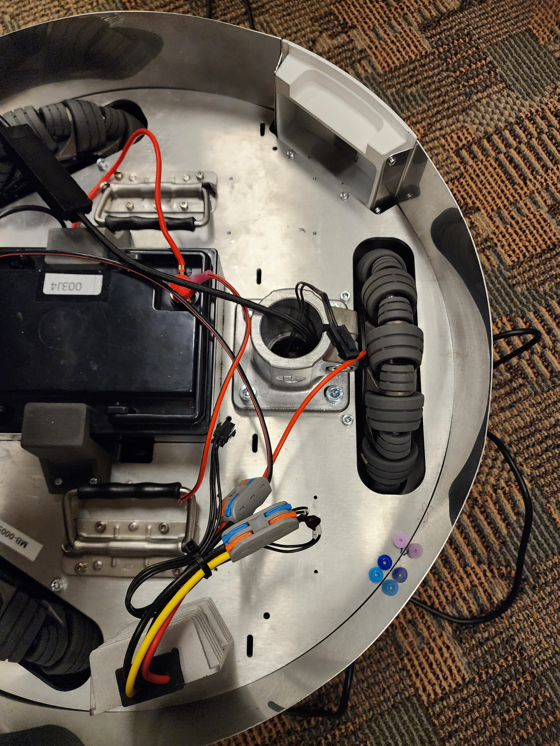

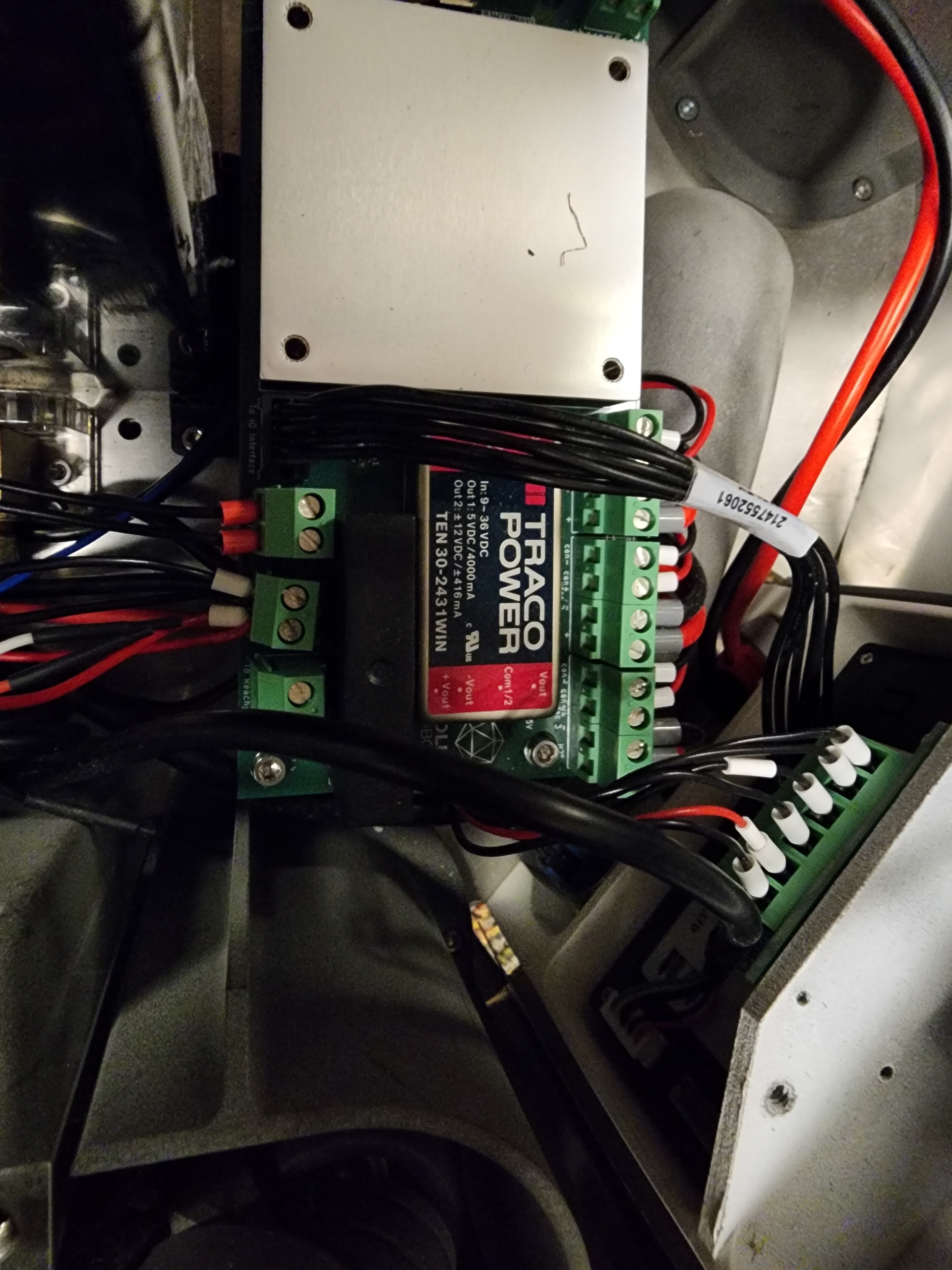

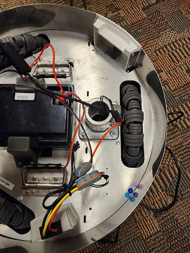

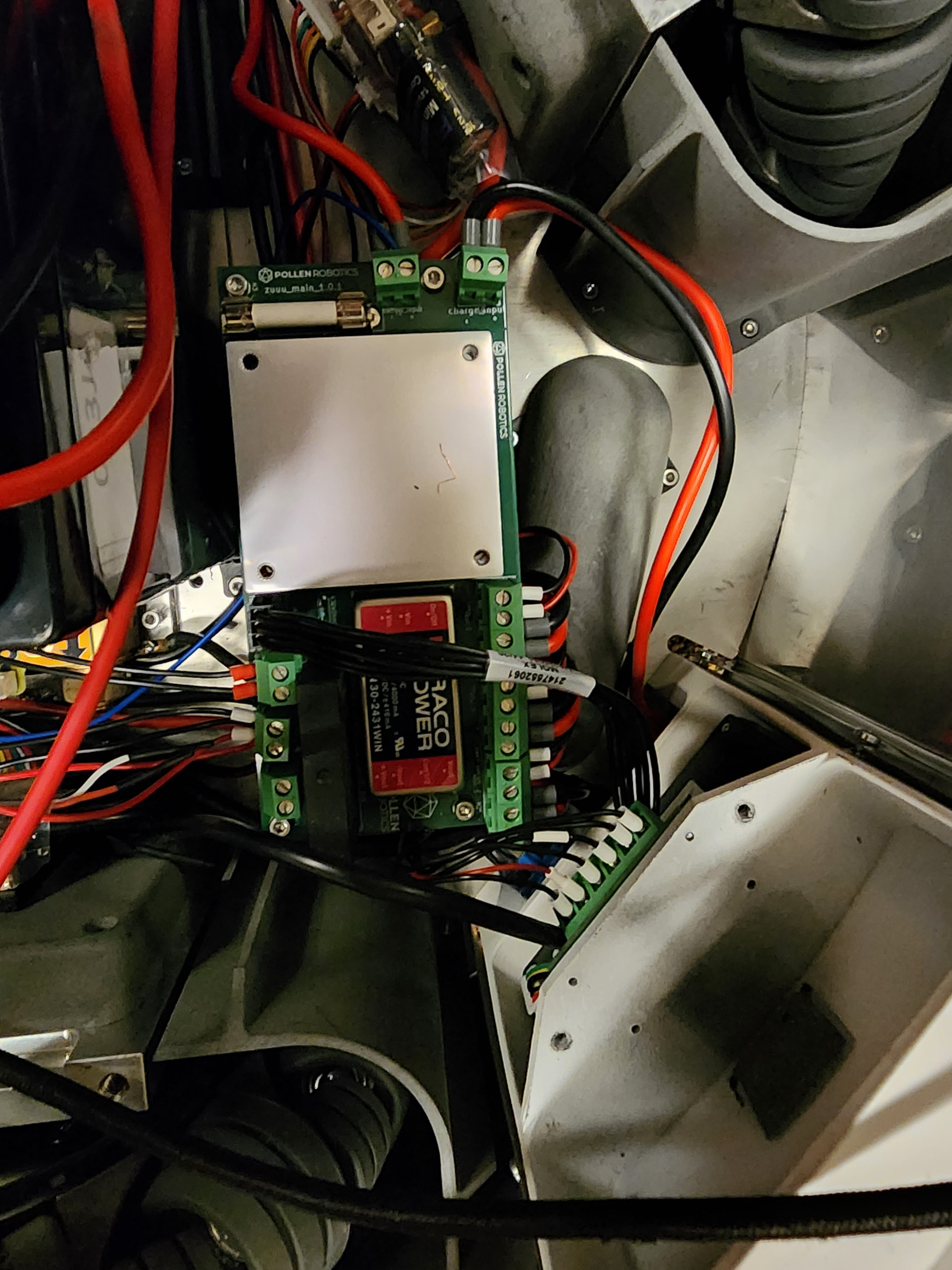

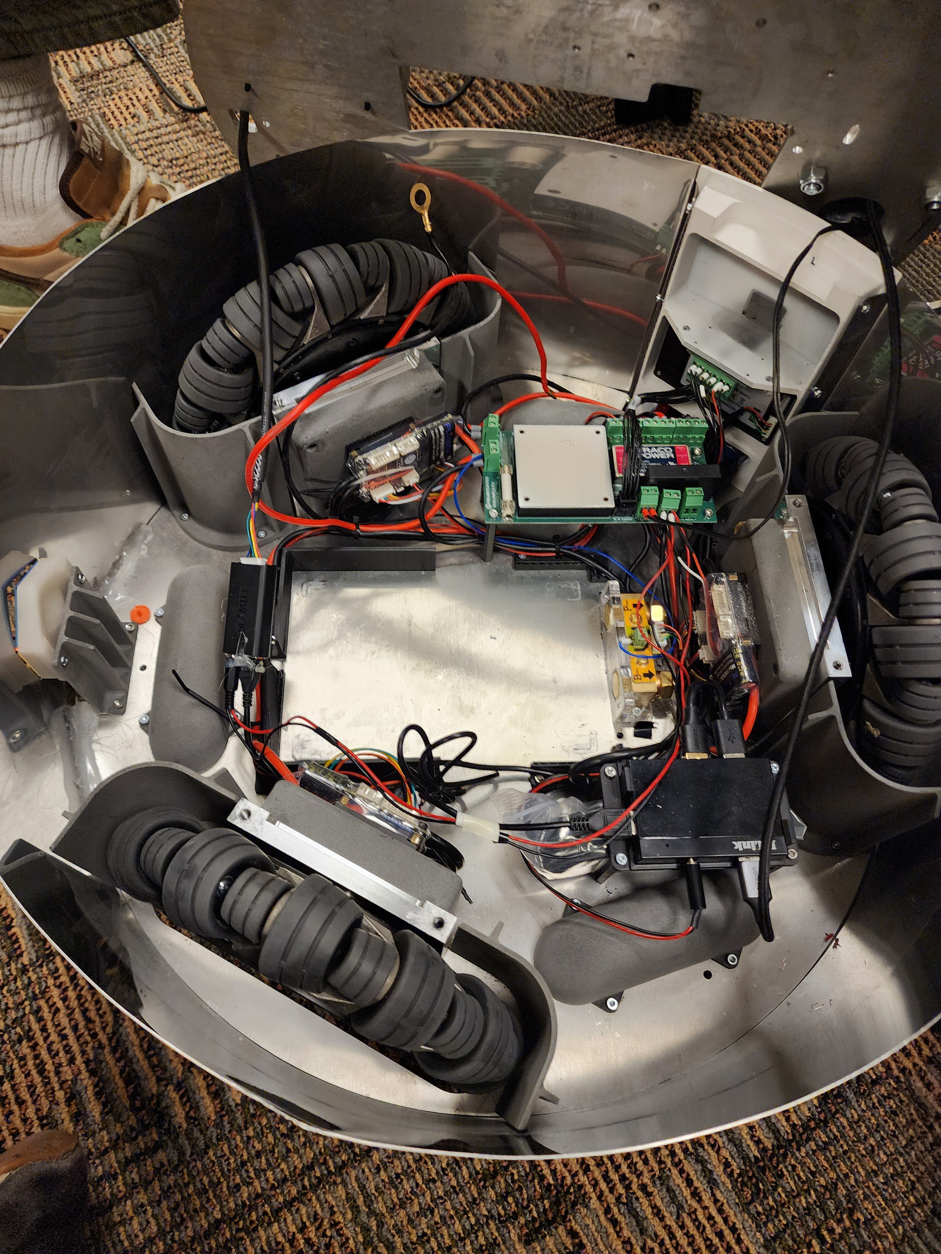

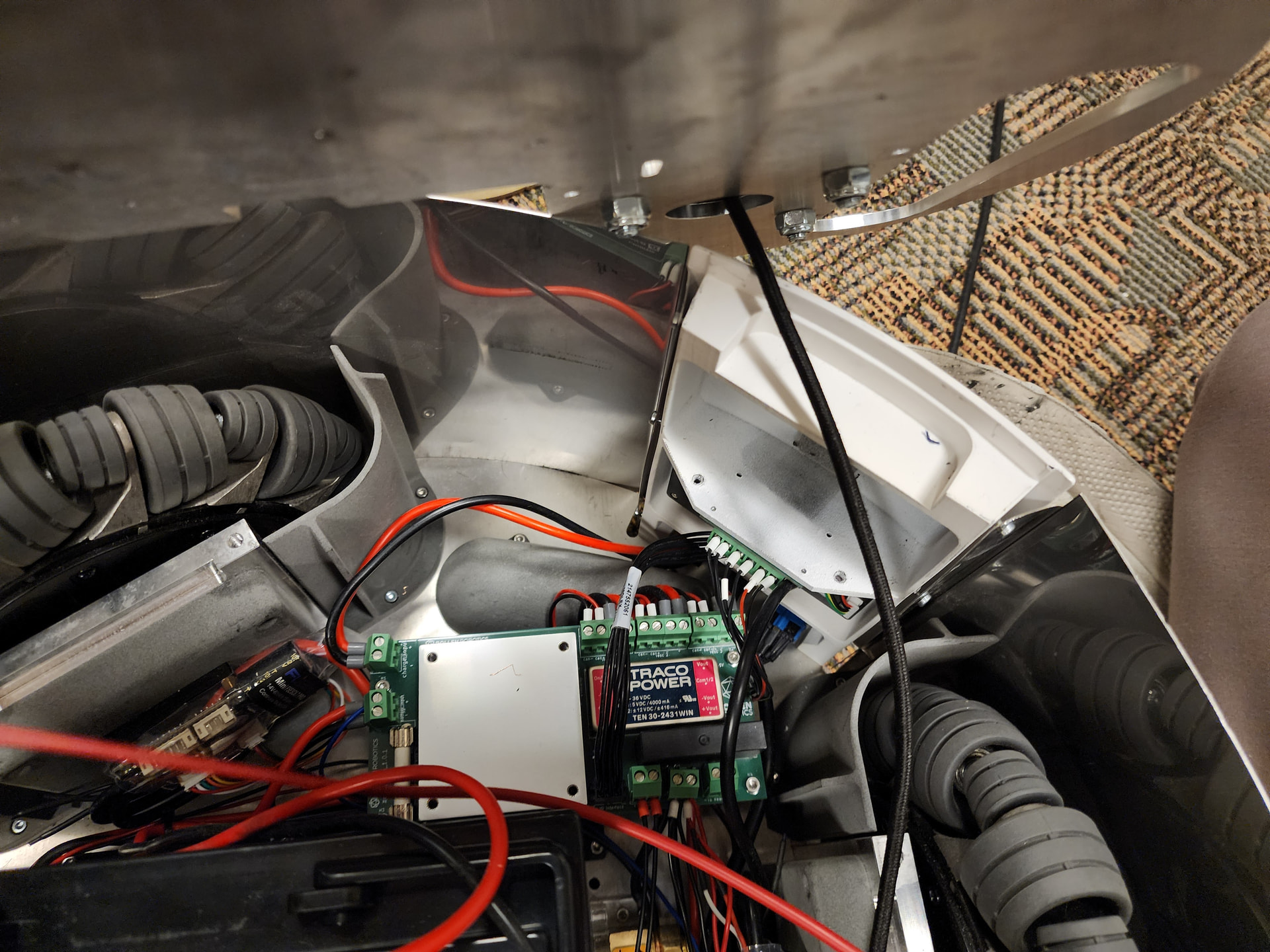

Here are some more images of the base, not sure if they would be helpful for debugging, thank you!

Hi @jyau,
Sorry for the delayed response! Thank you very much for your prompt reply and photos. In terms of power supply, everything seems fine, so we will check if there is a problem with the electronics.
Several checks:
  1. Could you check that once the mobile base is switched on, you have a blue LED behind each wheel?
  2. On the black USB hub: Could you disconnect the USB extension cable (which connects the mobile base to the robot body) from the mobile base, disconnect USB port 1 (see the image), and reconnect this port to the extension cable. Then, when connecting to the robot, check that you can access ls /dev/vesc_wheels,
  3. Do the same with USB port 2, and check that you can access ls /dev/rplidar_s2
If both do not work, it is probably a problem with the USB extension cable. If one does not work, it is probably a problem with a connector upstream of the hub. If both work, it is probably a problem with the hub or the USB cable connecting the hub to the extension cable.
Could you also send me an email at claire.houziel@pollen-robotics.com with your address, in case we need to send you replacement equipment, please ?
Thanks a lot and have a nice day!

Hi @jyau ,
We checked on our end on a mobile base to try to find the configuration that could cause your symptoms.
The fact that none of the VESC LEDs are lit points us toward the power supply. A disconnected cable between the VESC and the hub would not cause this.
Could you remove the fuse (after activating the emergency stop, turning off the mobile base, and disconnecting the battery power supply) and check with an ohmmeter to see if you have anything?
Can you also tell us if, when you turn on the mobile base, the button lights up blue and the interface above the button lights up with a percentage > 0%? And is there a blue led on the hub ?
If the fuse is OK, it is probably the mobile base’s electronic board that is faulty. We will send you a replacement, along with instructions on how to change it!
I have received your email, so I have all the information I need to proceed!
Hi Claire,
Thank you for all your help! For the checks mentioned:
About removing the fuse (I followed the directions but just confirming, is the fuse the white cylinder on the electronic board?): I’m not sure which pins to check so I just checked all the pins following the pin numbering diagram from the first reply:
  1. ~45kOhm
  2. ~45kOhm
  3. ~74Ohm
  4. ~4kOhm
  5. ~74Ohm
  6. ~5kOhm
  7. ~78Ohm
  8. ~5kOhm
  9. 0Ohm
  10. ~23kOhm
  11. ~6kOhm
About turning on the mobile base: the interface turns on with more than 0% but the button doesn’t light up and the USB hub does not have the blue LED lighting up.
I’m not sure if the checks above help confirm if the fuse is OK, but thank you very much! Please let us know if there is anything else needed from our side!
Hi @jyau,
I’m sorry, my last message was not clear : could you measure the resistance value of the fuse with the ohmmeter, placing a probe on each side of the fuse?
Ok, so it seems that the electronic card of the mobile base is faulty, we are going to send you a new one as soon as possible ! (But we still need to know if the fuse has blown as well)
