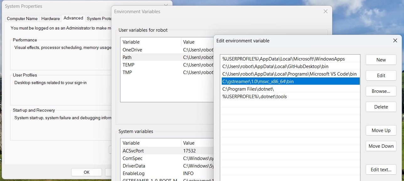

To be sure there is no issue with the settings of your Quest 3S, could you test on another app where there is stereo vision, and not just the Quest home environment ?
Also, it can be an issue of Gstreamer installation : did you use the installer, and did GStreamer install correctly when you installed the app? You can try to reinstall the app to be sure.
Otherwise you can download it directly : https://gstreamer.freedesktop.org/download/#windows, then check that the environment variable PATH contains C:\gstreamer\1.0\msvc_x86_64\bin (default installation) For that, look for “Edit the system environment variables” in the Windows search bar. Then, click on Environment variables. A new window shows up : double click on “Path” in the user variables. If you don’t see the gstreamer variable, select “New” and add the pathway above. setting env variables
Reboot after installation.
About the logs, I’m sorry I don’t see the mail with the new logs; I have the last one but where we can’t see the start of the error unfortunately. (the log about self.x_vel_goal is not a concern)
Hi Claire,
A few updates:
  1. I tested stereo vision in other Quest apps, and stereo vision works normally there. The issue only appears in the Reachy app during teleoperation.
  2. I also checked GStreamer on the Windows PC, and it seems to be installed and working correctly. gst-launch-1.0 --version and gst-inspect-1.0 --version both show GStreamer 1.26.11. The test pipeline gst-launch-1.0 videotestsrc ! autovideosink runs successfully and displays the normal test pattern using the Direct3D12 renderer on the NVIDIA GTX 1080 Ti. I also confirmed that udpsrc, rtph264depay, and avdec_h264 are available.

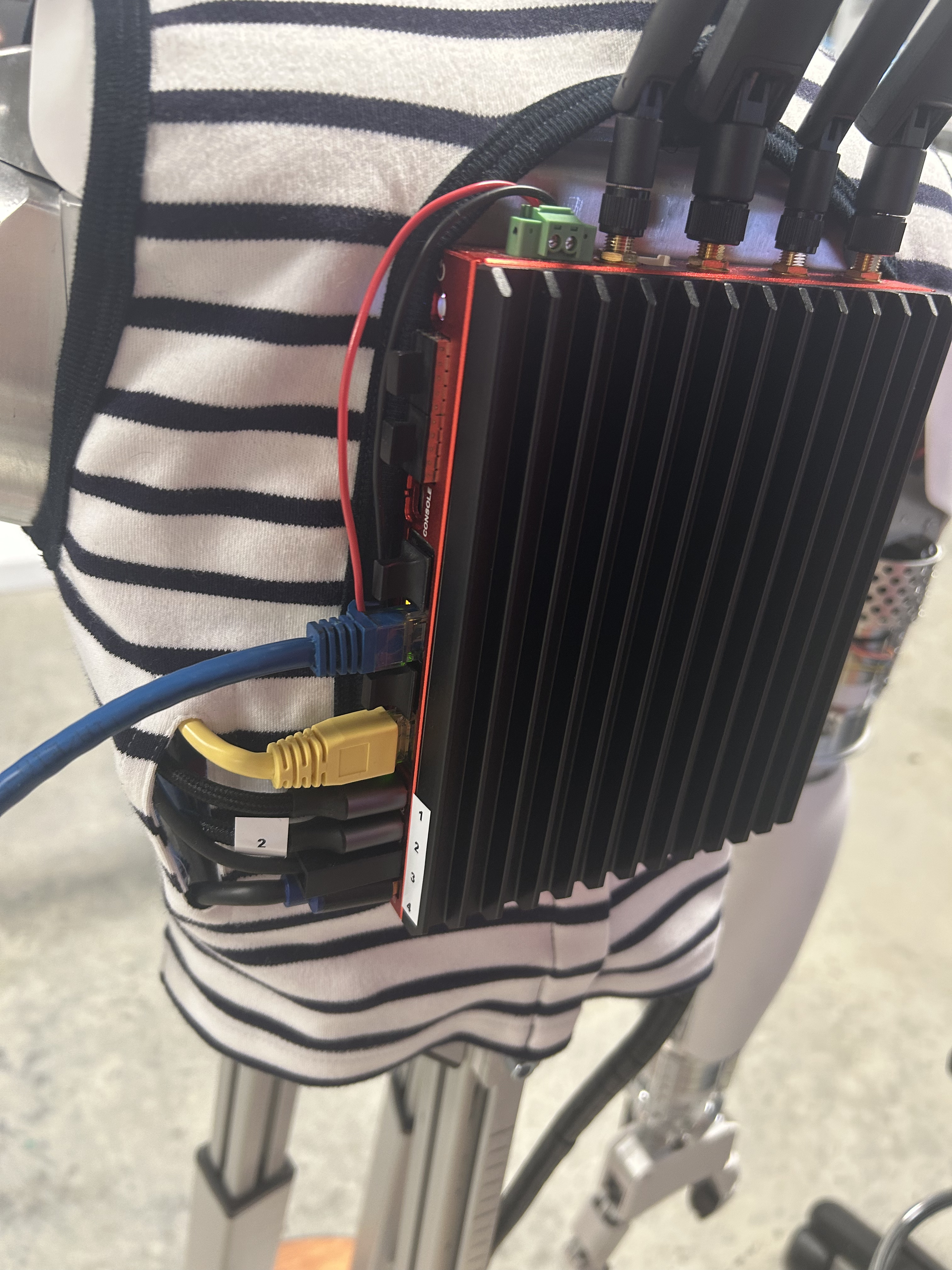

For the error of the core, this seems to point to a faulty EtherCAT cable: could you try restarting the core, then gently wiggling the yellow cable on the EtherCAT port of the Bedrock to see if the error you’re seeing reappears? (as shown in the screenshot)

For the EtherCAT/core issue, I tested the yellow cable (shown in the attached photo) five times. Only reachy2-test-EtherCAT-1.txt triggered a failure: it showed a timeout around NeckOrbita3d / slave 0, followed by ros2_control_node crashing and multiple critical nodes failing. The other four tests seemed normal: the core restarted correctly, found all 7 slaves, and reported “Master and all slaves operational”.
Also, during the wiggle test, I moved the yellow cable much more than it would normally move during teleoperation, so I’m not sure this fully explains the normal teleop behavior.

Hi @Khal1L
Thanks for your detailed answer !
You can run a test on the bedrock to try to catch errors from the Ethercat :
  1. SSH to the bedrock : ssh bedrock@r2-0008.local (mdp:root)
  2. Clone the repo : git clone https://github.com/pollen-robotics/poulpe_ethercat_controller.git
  3. cd poulpe_ethercat_controller
  4. git lfs pull
  5. cd target/release/examples
  6. ./get_bus_state --configfile ethercat.yaml(if the core is not launched, add –start-server)
  7. Screenshot the output
You can try it when you have the error or when you wiggle the yellow cable.
Also, if you have the error of ethercat, could you run ethercat slavesand copy the output ?
