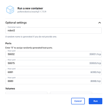

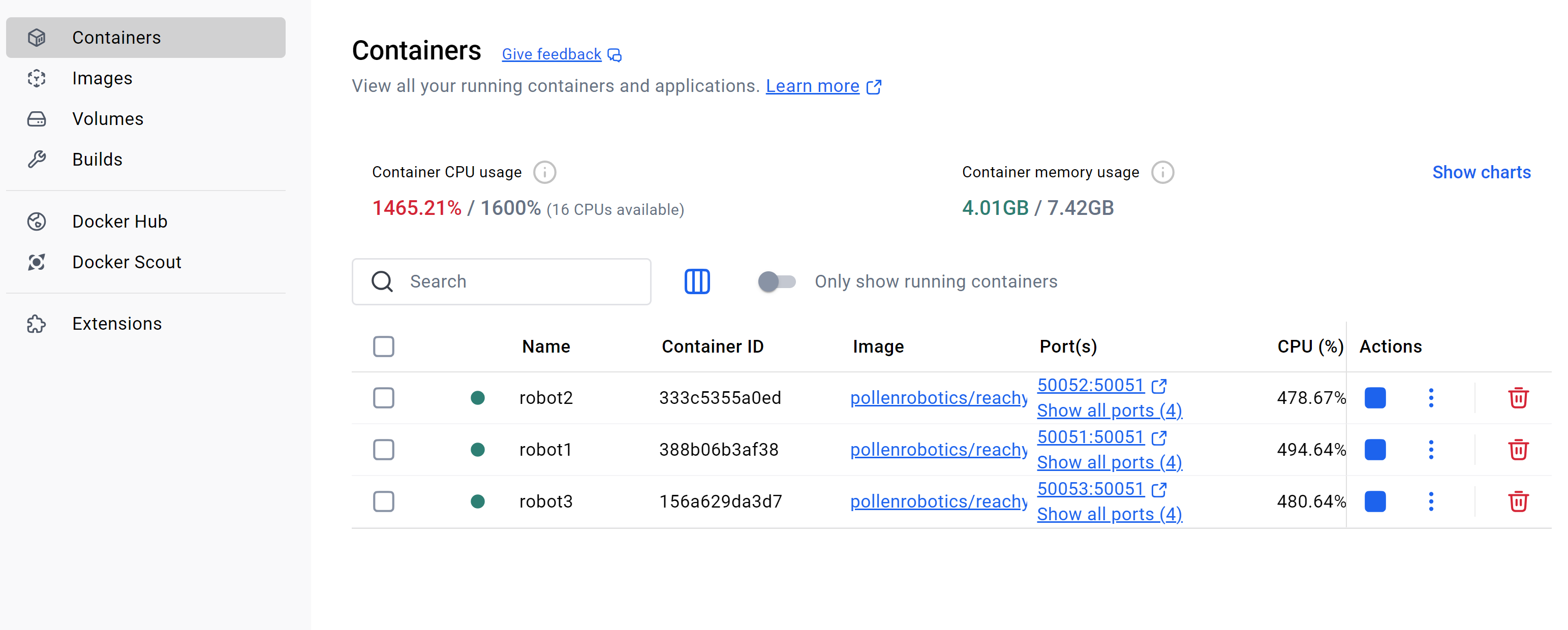

If you followed the documentation for installing the simulation and are using Docker Desktop, things are even easier.
When setting up your container, you can directly select the new ports in the Optional settings (make sure you never assign the same port twice):
This way, you can run several containers at the same time, each one simulating a different robot:
To control the robots through our Python SDK, use the branch mentioned in part 2 (Controlling the robots through the Python SDK) of the previous message!

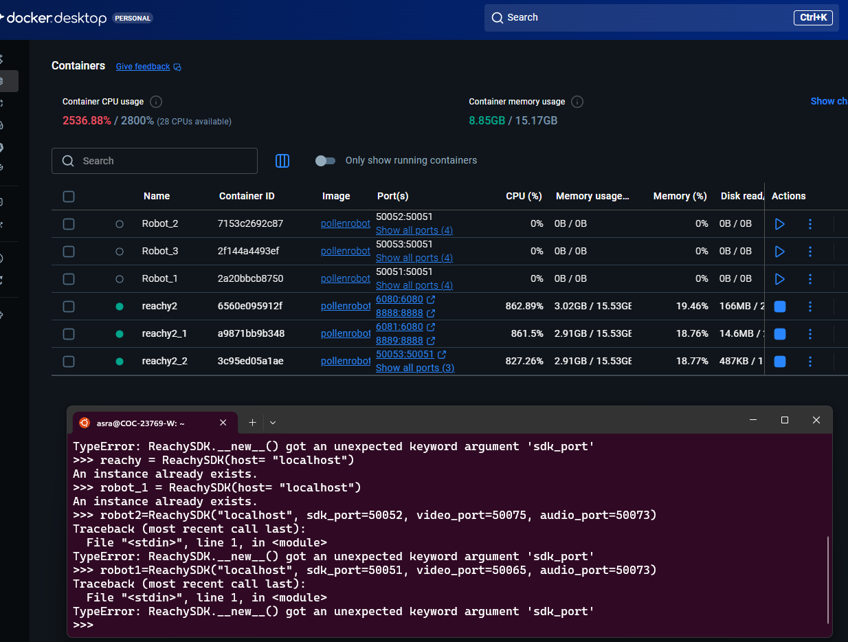

Hello, I appreciate such detailed solution. I have three docker container, I tried directly through desktop but was not able to run all three through docker desktop but I ran the three docker container using the commands below:
docker run --rm --platform linux/amd64 -p 8888:8888 -p 6080:6080 -p 50051:50051 --name reachy2 ``docker.io/pollenrobotics/reachy2`` start_rviz:=true start_sdk_server:=true fake:=true orbbec:=false gazebo:=true
docker run --rm --platform linux/amd64 -p 8889:8888 -p 6081:6080 -p 50052:50051 --name reachy2 ``docker.io/pollenrobotics/reachy2`` start_rviz:=true start_sdk_server:=true fake:=true orbbec:=false gazebo:=true
docker run --rm --platform linux/amd64 -p 8890:8888 -p 6082:6080 -p 50053:50051 --name reachy2 ``docker.io/pollenrobotics/reachy2`` start_rviz:=true start_sdk_server:=true fake:=true orbbec:=false gazebo:=true
As guided above for controlling the three reachy2 in unity using python sdk, I am running the commands above and having an error:
Can you please guide me. Thank you!
Hello @AAK,
Did you change the branch of reachy2_sdk as mentioned in the part “2. Controlling the robots through the Python SDK“?
The branch must be set to fix-ports-setup GitHub - pollen-robotics/reachy2-sdk at fix-ports-setup , otherwise you will get the error “TypeError: ReachySDK.__new__() got an unexpected keyword argument ‘sdk_port’”, which seems to be the error you have.
