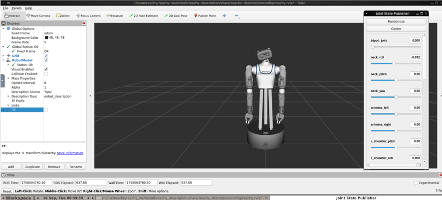

I can try to move the robot joints with “rqt_controller"_gui” node running “ros2 run joint_state_publisher_gui joint_state_publisher_gui”.
The GUI is shown in VNC server:
If I move its axes in the GUI, the actual robot does not respond.
