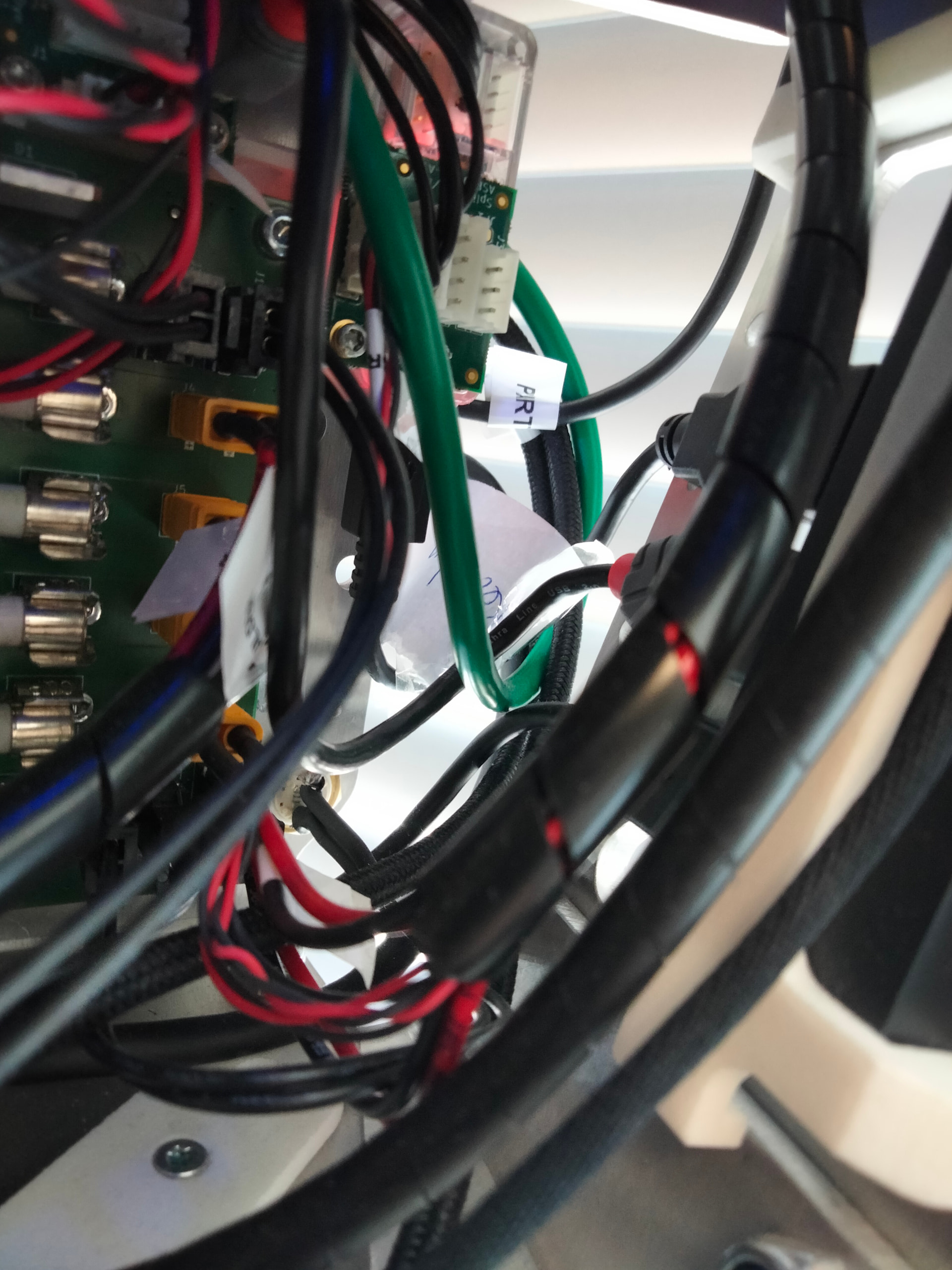

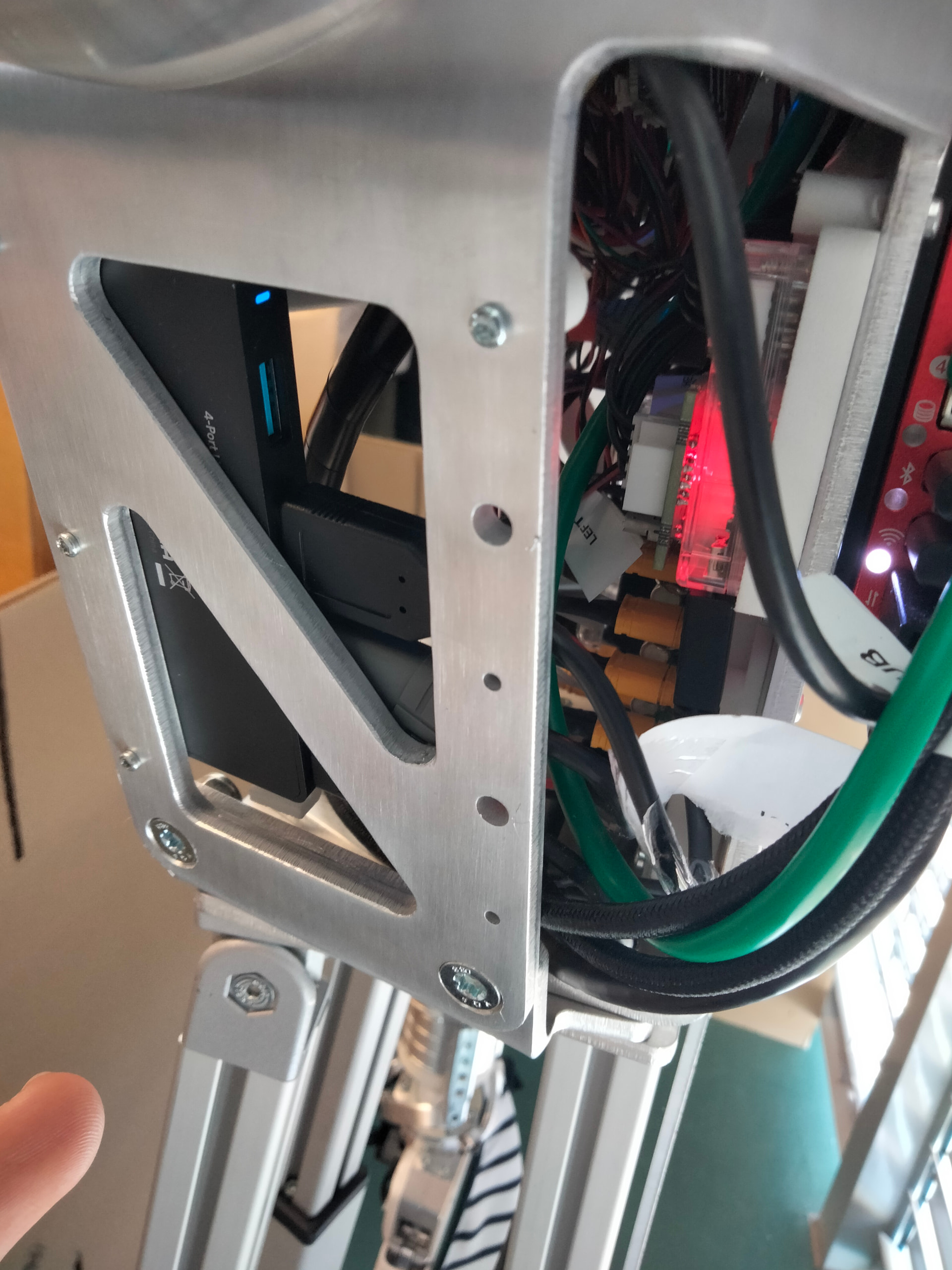

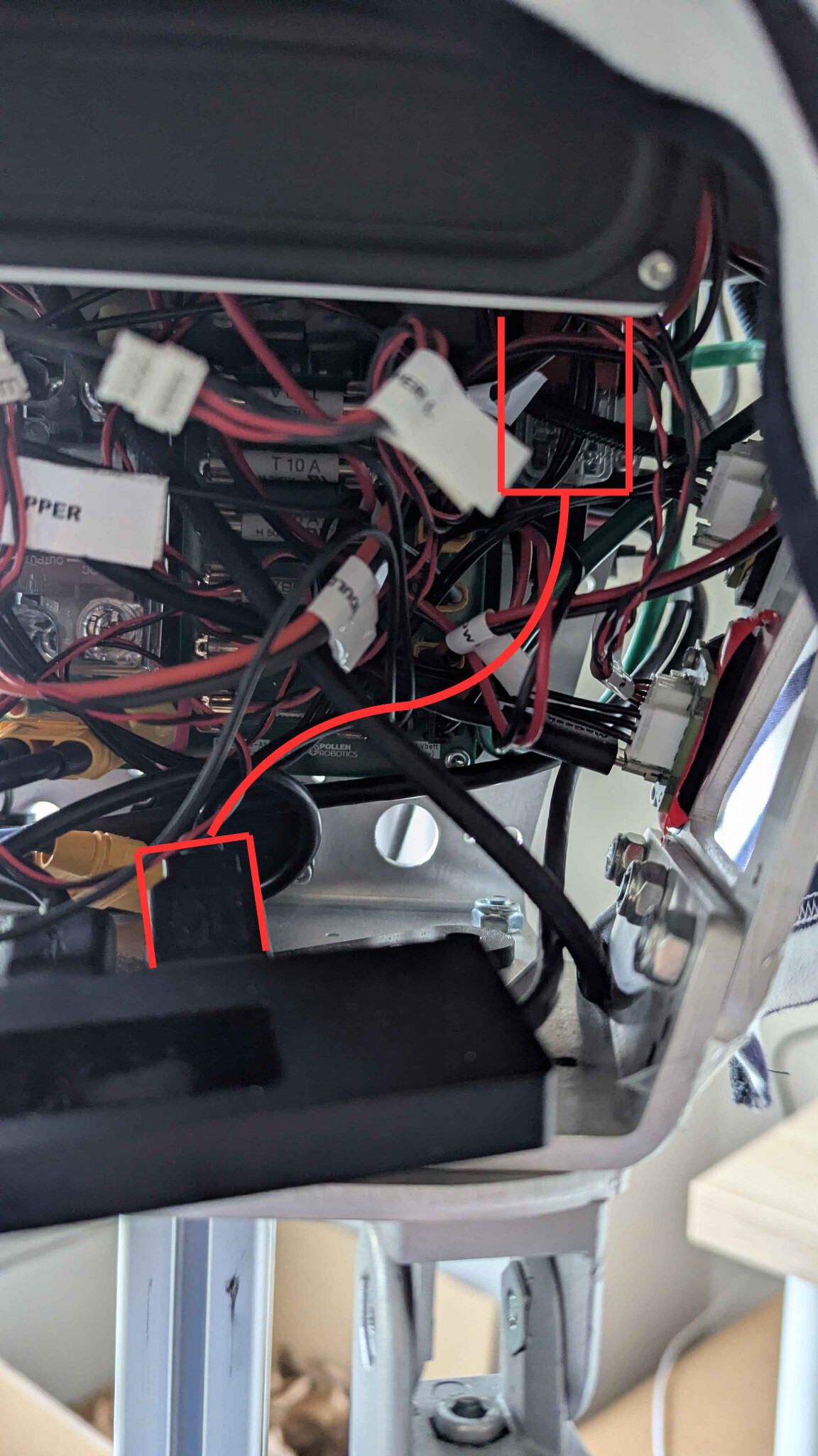

Hi @alvaro_solana
Could you add some information to help us debug your issue :
  • the entire logs when the system is crashing (by ssh to the robot then executing journalctl -fu reachy2-core)
  • are you able to access ls /dev/grippers when the system is crashing ?
  • if you restart the core via the dashboard, without touching the cable, does it work ?
It could be that the U2D2 connector has been damaged from being plugged in and unplugged often, since it’s quite fragile. We could send you a replacement U2D2 and a cable, and make a video to show you how to replace it. To do this, could you take a photo of the inside of the robot, near the U2D2, so we can see the current setup?
Thanks and have a nice day,
Claire

4. Photo and Replacement: I agree that the U2D2 port might be damaged or failing to initialize properly on cold boots. I have attached the photo of the inside of the robot, near the U2D2 setup.
Sending a replacement U2D2, a new cable, and the tutorial video sounds like the best approach. Please let me know the next steps.

Thanks a lot @alvaro_solana !
Could you also try pressing and then releasing the emergency stop button to see if that allows the stack to start up?
We are going to send you the cable and another U2D2 for replacement, could you please send me your address, name, mail and number of telephone on claire.houziel@pollen-robotics.com ?
Have a nice day,
Claire
Hi Claire,
Thank you! I have just sent you an email with my shipping details.
Regarding the E-Stop: No, pressing and releasing the emergency stop button does not allow the stack to start up. The system keeps crashing with the same missing interfaces error. The only workaround is still physically unplugging and replugging the micro-USB cable.
Have a great day! Alvaro
