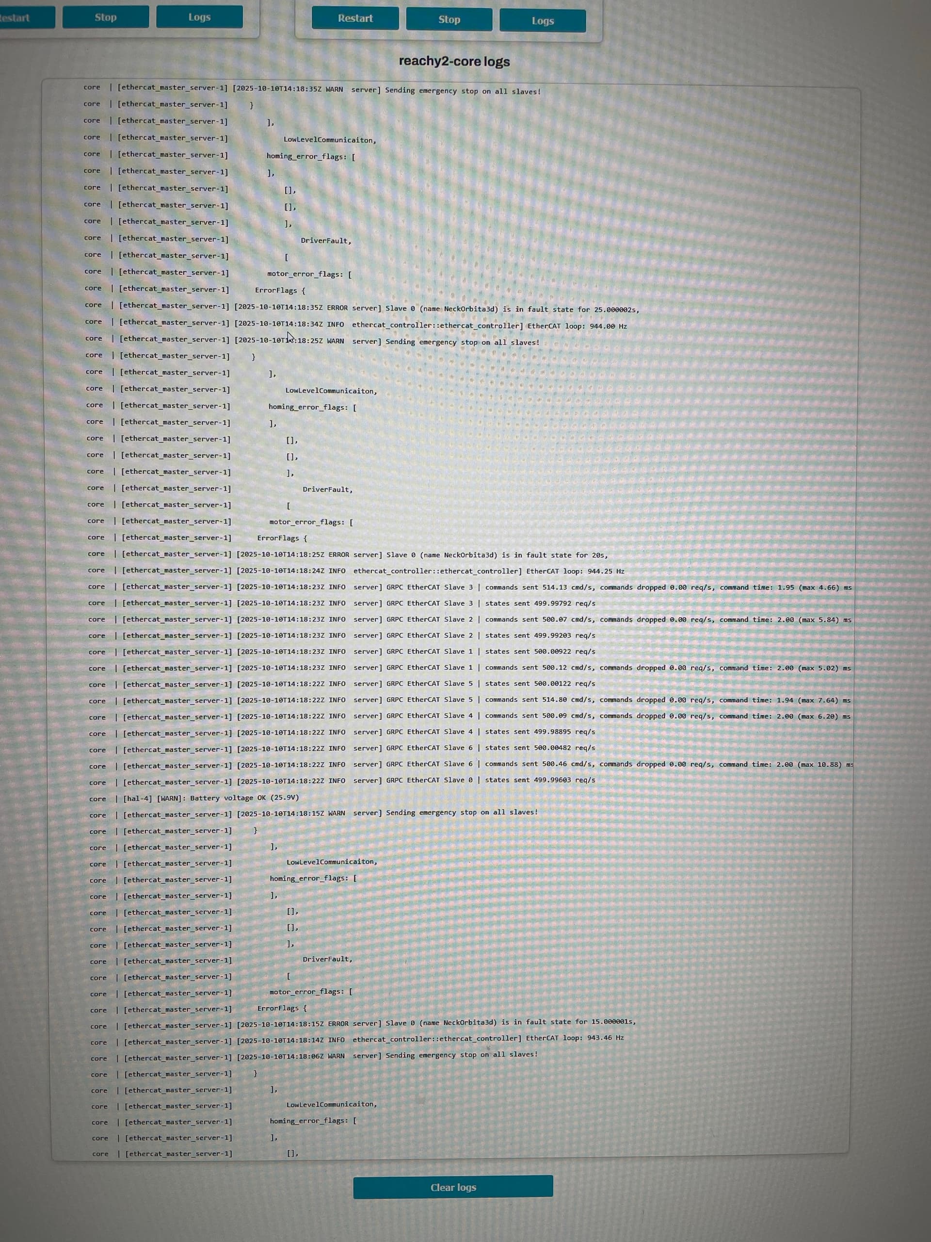

For some reasons the copy/paste of your error log includes some special characters… “”
Could you please take a screenshot instead? Just to be sure we are not missing something?
Hi @Steve here is a pic of the logs.
Ok thanks!
Sorry about that, we are investigating the problem, but it looks like some kind of physical connection problem in the electronics. For example I can reproduce the same error if I unplug a motor from the electronics after the init. Maybe the transport did shake the robot a little bit too much?

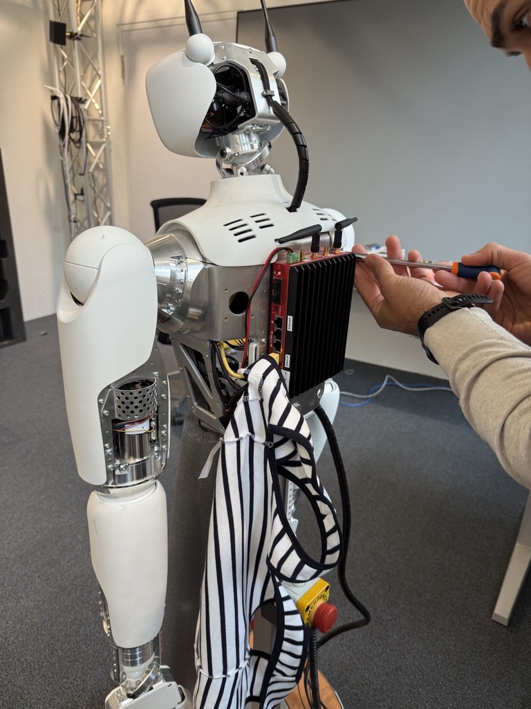

Reachy is operating without any errors again! @antun was here and gave him a new neck :slight_smile: Debugging of the old one can be done in the lab later.
