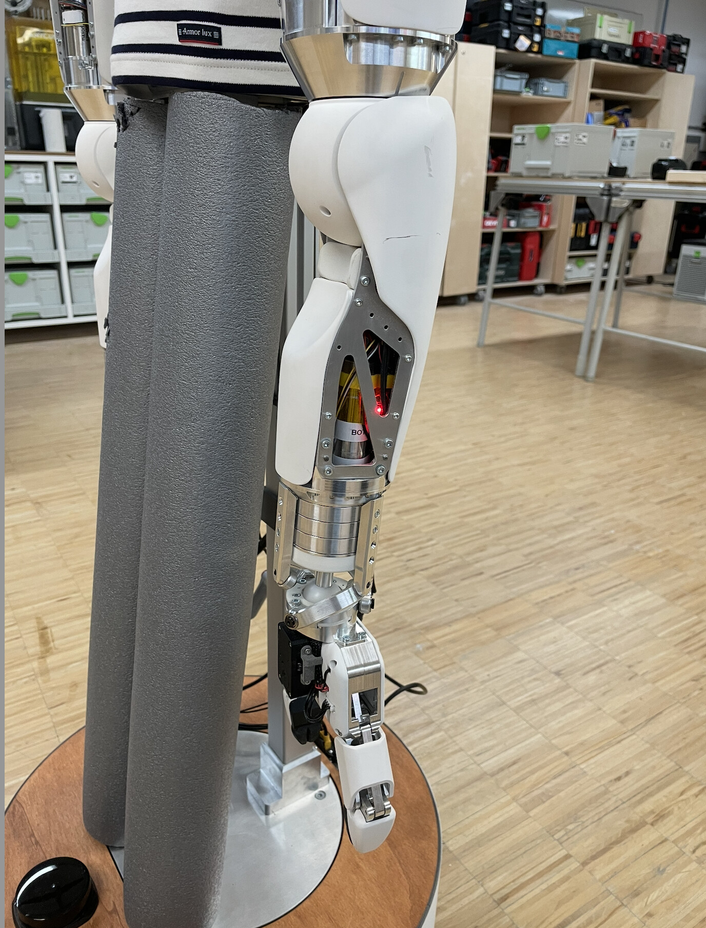

Hi I am getting following error and the core service cannot start:
ros2_control_node-2] [ERROR]: Failed to init dxl_controller with config file: “/home/reachy/reachy_ws/src/reachy2_core/reachy_config/config/default/grippers.yaml”
[ros2_control_node-2] [WARN]: System hardware component ‘gripper’ from plugin ‘dynamixel_2joints_system_hwi/DynamixelSystem’ failed to initialize.

Red LED is also active in his left arm, see picture
Hi @alexandros,
It seems that the grippers are not connected.
Could you please try logging into the main pc and running the command ls /dev/grippers to see if the usb connection to them is detected.

Also tried to teleoperate. Everything works except, closing opening the gripper …
This is very strange indeed.
If you were able to enter to the service that means that you now can see the grippers serial port if you run:
ls /dev/grippers
Is that right?
Can you see the antennas?
ls /dev/antennas
I can see the antennas, but not the grippers.
bedrock@r2-0002:~$ ls /dev/antennas
/dev/antennas
bedrock@r2-0002:~$ ls /dev/grippers
ls: cannot access ‘/dev/grippers’: No such file or directory
Hmm…. this could be a usb issue maybe.
Do you maybe have a microusb cable to spare?
You could maybe try to replace the usb cable going from the U2D2 to the USB hub. The ideal would be to replace both of the cables connecting both of the U2D2s to the hub, to be sure.
If you do not have two microusb cables to spare you can maybe try replacing one by one.
If this turns out to be a reason we will ship you the new cable and the U2D2 asap!
Hi Antun, I changed one of the 4 MicroUSB cables and it works again….
I am not sure if this was the case but it works for the moment.
THANK you for your help!
