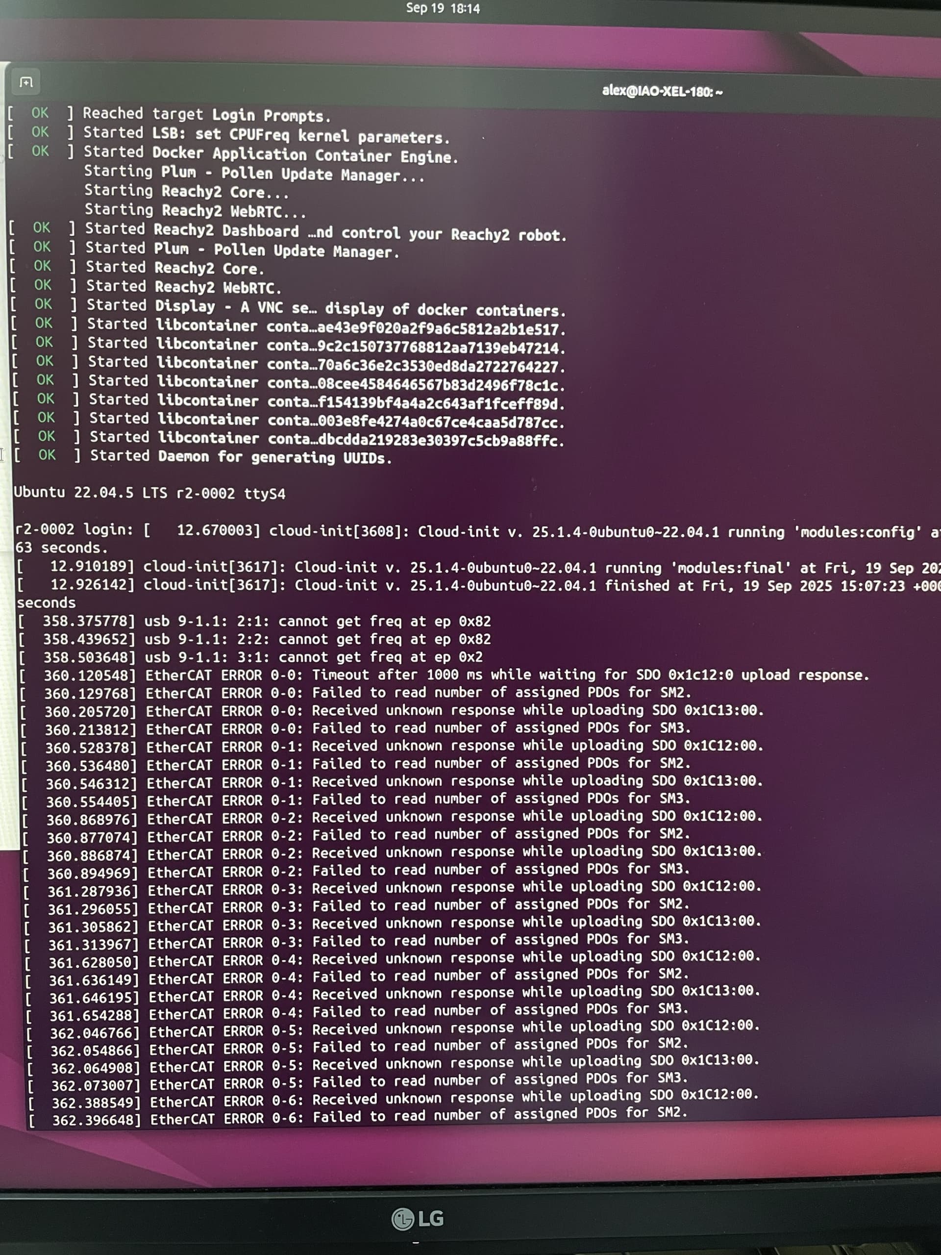

after updating Reachy2 and rebooting , I am getting the repeating bubble sound and the core service cannot start.
There is an error about “bad serial number” but dont know what to make of it. Attached you find also a screenshot from the tio session, where I also got a grub and ethercat error. The grub error does not persist. I can log on to the bedrock pc via tio and ssh and also on to the dashboard via ethernet connection.

Hi @alexandros ,
The version of the core you’re using (v1.7.5.2) is a bit outdated, could you use the instructions from this page of the documentation to switch to the v1.7.5.9 (this version is in deploy mode, select plum mode: deploy in the top right selector), reboot the robot and check if the problem persists?
This version should patch your issue. We are finalizing the test on this version to pass it in release state asap. Switching to this version in deploy mode while we are doing the release should let you use the robot properly.
EDIT: we just put the v.1.7.5.9 in release, so you should be able to update the core directly from the dashboard!
Hi @Simon , thank you, it works now!
