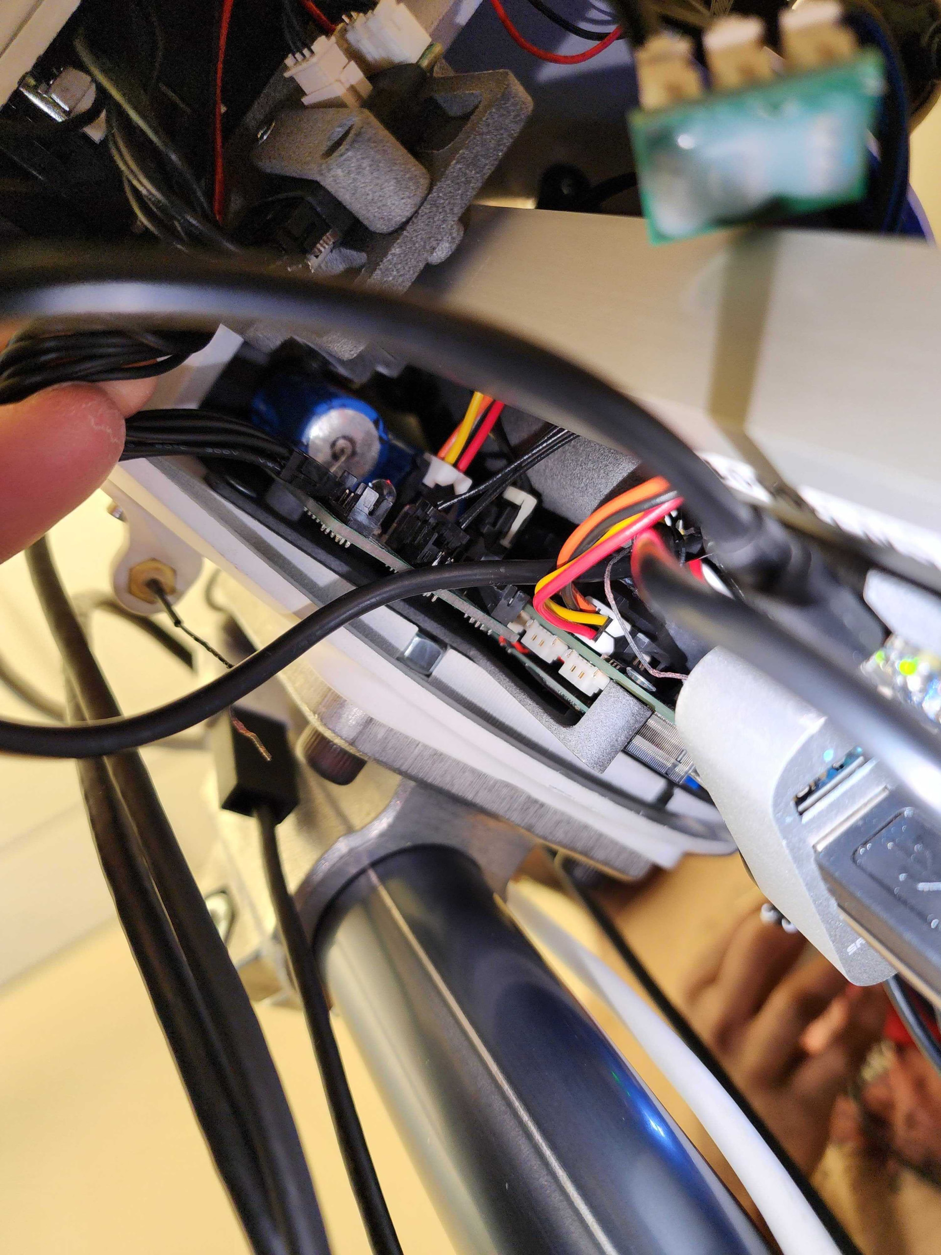

I think this error is coming from motors of the two arms. I noticed that when plugging in the power cord and turning the switch on to power the motors, the Dynamixel shoulder motors would light up briefly before, but do not light up now. I suspect maybe not enough power is being supplied to the arm motors for some reason? The computer can still turn on fine and mobile base also seems fine, MobileBaseSDK can still start up.
I was wondering there may be suggestions on what issues to check for and hopefully fix?
Thank you very much!

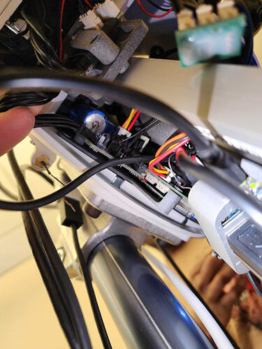

We looked more into the issue and we found that the circuit board that is powering the torso and the arms, is not giving 12V to the two arms for some reason.
We would really appreciate any advice and suggestions on how to fix this issue, thank you so much!
