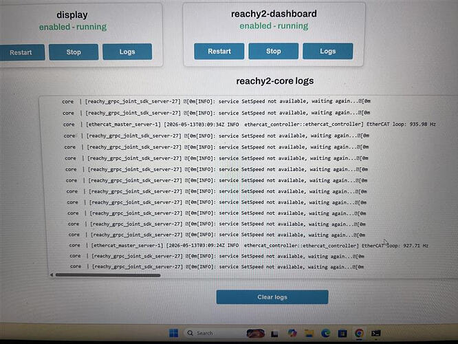

Reachy 2 mobile base issue: SetSpeed service not available
Hi Pollen Robotics team,
I am having an issue with the Reachy 2 mobile base. The dashboard can open and I can SSH into the robot, but when the mobile base is enabled, the core logs repeatedly show:
service SetSpeed not available, waiting again...
The Python SDK also cannot properly connect to/control the robot when this happens.

and restart reachy2-core, the robot core works better for head/arms. But when I enable the mobile base again, the SetSpeed not available issue returns.

However, the main repeated issue when enabling the base is still:

The same type of error also appeared for multiple UDP ports on the robot IP:
1781755516.225736 [1]        tev: ddsi_udp_conn_write to udp/10.116.19.109:7660 failed with retcode -1
1781755516.225751 [1]        tev: ddsi_udp_conn_write to udp/10.116.19.109:7662 failed with retcode -1
1781755516.225758 [1]        tev: ddsi_udp_conn_write to udp/10.116.19.109:7664 failed with retcode -1
1781755516.225765 [1]        tev: ddsi_udp_conn_write to udp/10.116.19.109:7666 failed with retcode -1
1781755516.225771 [1]        tev: ddsi_udp_conn_write to udp/10.116.19.109:7668 failed with retcode -1
1781755516.225777 [1]        tev: ddsi_udp_conn_write to udp/10.116.19.109:7670 failed with retcode -1
1781755516.225783 [1]        tev: ddsi_udp_conn_write to udp/10.116.19.109:7672 failed with retcode -1
1781755516.225789 [1]        tev: ddsi_udp_conn_write to udp/10.116.19.109:7674 failed with retcode -1
1781755516.225799 [1]        tev: ddsi_udp_conn_write to udp/10.116.19.109:7676 failed with retcode -1
1781755516.225809 [1]        tev: ddsi_udp_conn_write to udp/10.116.19.109:7678 failed with retcode -1
1781755516.225815 [1]        tev: ddsi_udp_conn_write to udp/10.116.19.109:7680 failed with retcode -1
The same type of error also appeared for localhost UDP ports:
1781755524.226805 [1]        tev: ddsi_udp_conn_write to udp/127.0.0.1:7882 failed with retcode -1
1781755524.226811 [1]        tev: ddsi_udp_conn_write to udp/127.0.0.1:7884 failed with retcode -1
1781755524.226816 [1]        tev: ddsi_udp_conn_write to udp/127.0.0.1:7886 failed with retcode -1
1781755524.226820 [1]        tev: ddsi_udp_conn_write to udp/127.0.0.1:7888 failed with retcode -1
1781755524.226823 [1]        tev: ddsi_udp_conn_write to udp/127.0.0.1:7890 failed with retcode -1
1781755524.226826 [1]        tev: ddsi_udp_conn_write to udp/127.0.0.1:7892 failed with retcode -1
1781755524.226830 [1]        tev: ddsi_udp_conn_write to udp/127.0.0.1:7894 failed with retcode -1
1781755524.226833 [1]        tev: ddsi_udp_conn_write to udp/127.0.0.1:7896 failed with retcode -1
1781755524.226836 [1]        tev: ddsi_udp_conn_write to udp/127.0.0.1:7898 failed with retcode -1
The grpc-webrtc-bridge-con container showed this startup sequence:
INFO:grpc_webrtc_bridge.server:Pipeline state changed from null to ready.
INFO:grpc_webrtc_bridge.server:Pipeline state changed from ready to paused.
INFO:grpc_webrtc_bridge.server:Pipeline state changed from paused to playing.
INFO:gst_signalling.gst_signalling:Connecting to ws://localhost:8443
INFO:gst_signalling.gst_signalling:Connected.
INFO:gst_signalling.gst_signalling:Starting input message handler.
There was also a command typo while checking Docker containers:
docker ps -a --firnat "table {{.Names}}\t{{.Image}}\t{{.Status}}"
unknown flag: --firnat
See 'docker ps --help'.
The correct Docker command worked:
docker ps --format "table {{.Names}}\t{{.Image}}\t{{.Status}}"
Since I am not attaching the log files here, I have copied the relevant terminal output directly into this message. Please let me know if you still need the raw .log files or a live capture while reproducing the teleoperation issue using:
journalctl -fu reachy2-core
journalctl -fu webrtc
Thanks a lot.

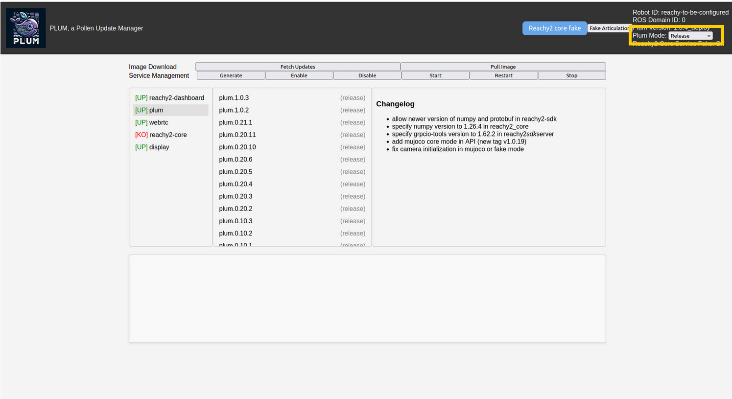

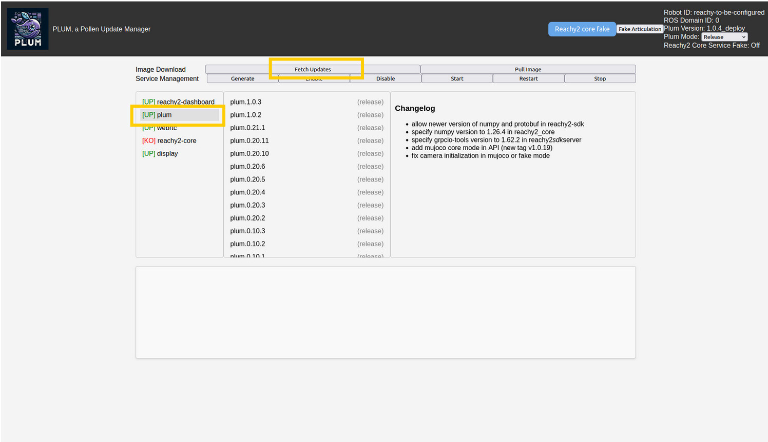

Hi @bannc
You can start by updating the versions of the services :

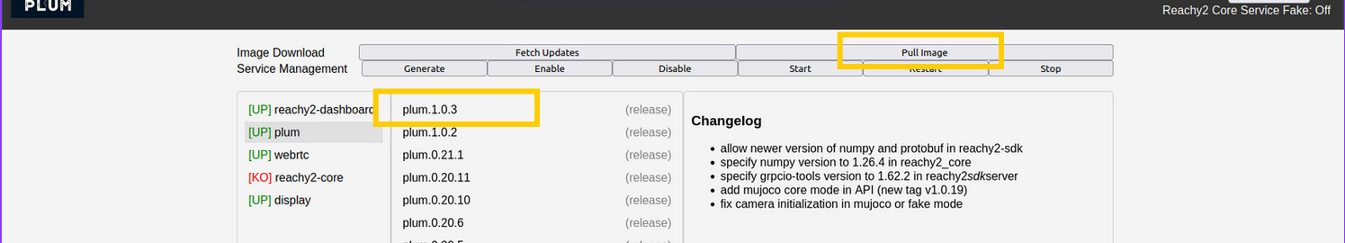

  1. Go to Plum : http://reachy2-pvt01.local:5000/
  2. Start by updating Plum service :

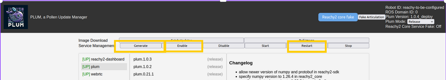

    a. Plum > Fetch Updates > plum.1.0.3 > Pull Image
    b. Wait for the image to be pulled (see the logs behind)
    c. Generate > Enable > Restart
  3. Refresh your browser and make your Plum mode on Release

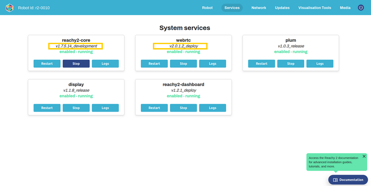

  4. Update with the same process each service :
    a. reachy2-dashboard : 1.2.1
    b. webrtc : 2.0.1.2
    c. reachy2-core : 1.7.5.9
    d. display : 1.1.8
If you need more informations, you can take a look on the documentation : How to Use Reachy 2 Dashboard for Updates – Advanced Management Guide
With those new versions, you can also update the Reachy2Teleoperation app for the last release : Release v1.1.2.0 · pollen-robotics/Reachy2Teleoperation · GitHub
For the mobile base to be disabled, the .reachy_config/reachy.yaml should look like this :
bedrock@reachy2-pvt04:~$ cat .reachy_config/reachy.yaml
mobile_base:
  enable: false
This file can be modified directly with the new version of Plum :
Fake Articulation > Tick the mobile base > Save Configuration > Back to Main Dashboard > Restart the reachy2-core service.
The error you see “tev: ddsi_udp_conn_write to udp/127.0.0.1:7882 failed with retcode -1” looks like a network issue, as if there had been a network switch while the core was running. You can try restart the webrtc service and core on a stable network and see if you still have it.
Could you try to start again the teleoperation with the new release of the app and the updated services, and if the error is still there, copy the entire logs ?
Thanks and have a good day,
Claire

Hi @bannc,
Could you :
  1. stop the plum service using either plum or the dashboard
  2. ssh to the robot
  3. docker pull pollenrobotics/plum:1.0.3_release
  4. cp /home/bedrock/plum.1.0.3.release.yaml /pollen/docker/plum/plum.1.0.3.release.yaml
  5. curl "http://127.0.0.1:5000/generate_service?file=plum.1.0.3.release.yaml&image=plum"
  6. sudo systemctl restart plum
Then you can get back to plum : http://reachy2-pvt01.local:5000/ and you should have the right version to follow the rest of my previous message.
Please keep us informed,
Have a good day
