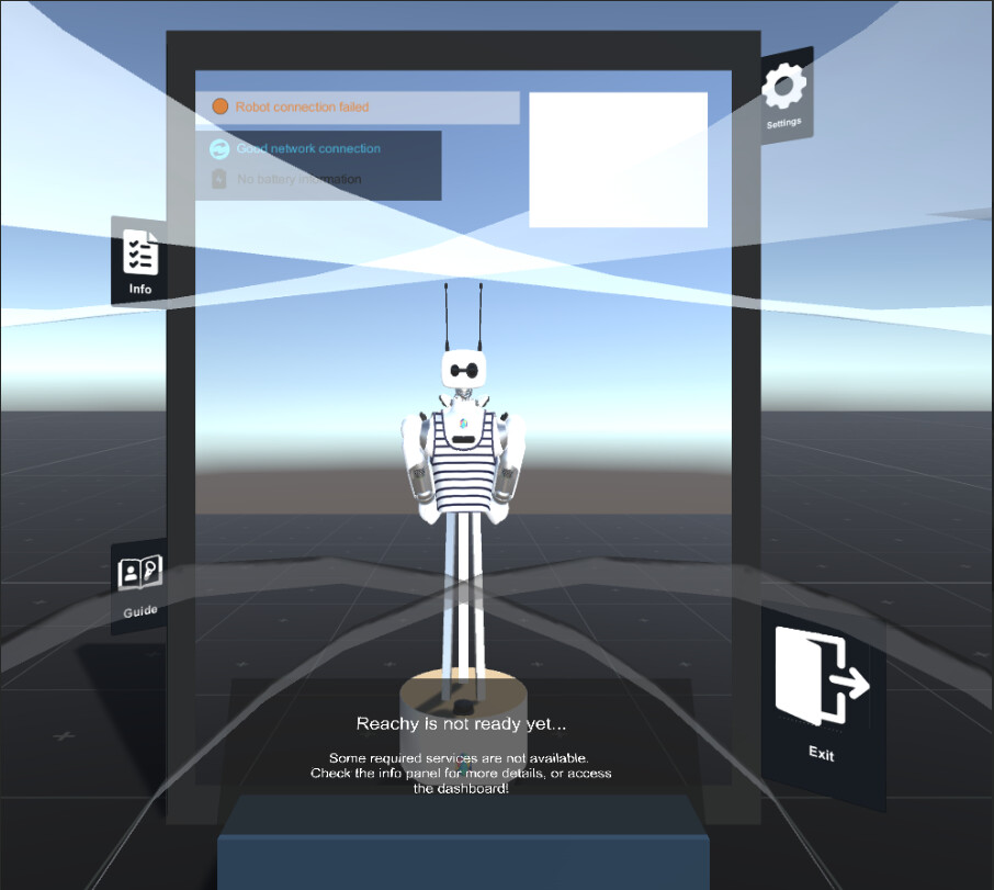

While trying to use the Teleoperation app on a windows computer connected using the horizon link app, and using the full app installer including gstreamer, with the included launch script, I get blocked on the “mirror” screen. The system will successfully connect to the robot and show the camera feed when the Quest headset is not connected, but when the headset is connected, the teleoperation app shows this screen:
and proceeds to not allow teleoperation
This is on version 1.1.2 of the application, running on Nvidia GeForce RTX2070

looking at the logs from the webrtc service provided by the dashboard, There is no specific connection error as it seems that the teleoperation app does not manage to connect to the system at all while the headset is connected, while it connects just fine when the headset is not connected
I have checked the Gstreamer and Visual C++ instructions and the windows path, and they are al in line with what you describe, but the problem persists.
