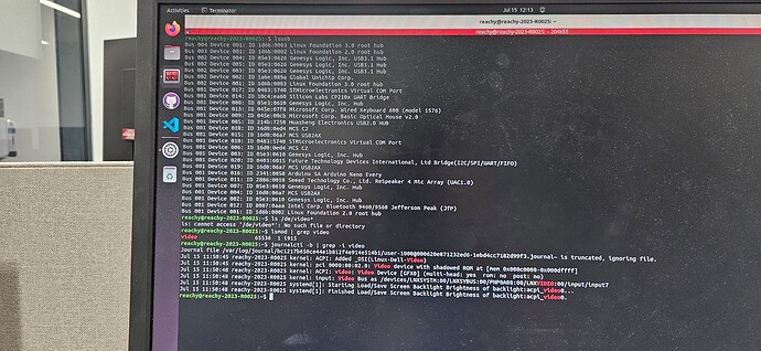

Despite multiple attempts, I have been unable to access or detect the cameras.

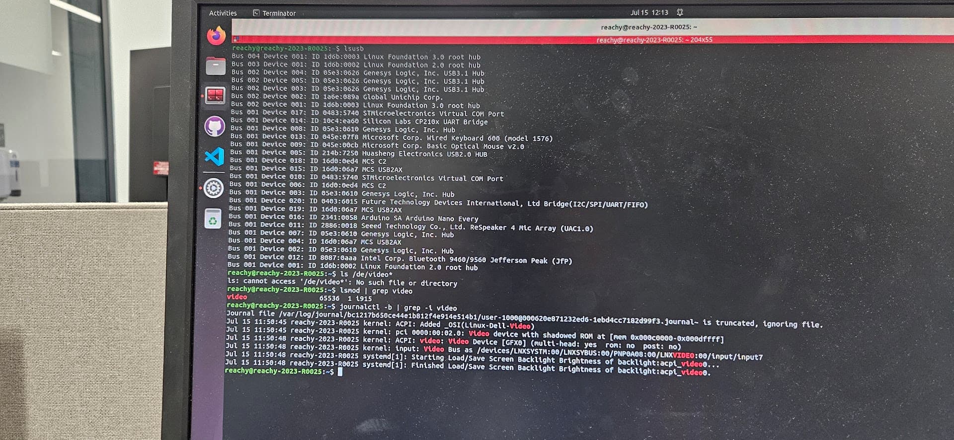

When connecting Reachy to an external monitor and launching a camera application such as Cheese, no webcam is detected. Also when running the following commands I have no infomation on the cameras as seen in the attached photos. `lsusb```, ls /dev/video*, ```lsmod | grep videoand ```journalctl -b | grep -i video``.
Given that the system appears to be functioning correctly otherwise, I suspect that the issue may be due to a faulty connection with the onboard camera or a hardware failure in the camera module.
Could anyone kindly advise on how to fix the issue such as any recommended steps to verify internal camera connections safely? And any additional diagnostic tools or logs we can check to further isolate the problem?
Any help in resolving this would be greatly appreciated. I am happy to provide system logs or run any additional commands you suggest.

From what I can see there is a typo when you typed ls /de/video* (a v is missing). Can you confirm that you don’t have any output when you type /dev/video* aswell?
There should be 8 outputs to this command, usually from /dev/video0 to /dev/video7 (4 outputs are created per camera)
Also can you try if the commands ls /dev/left_camera and ls /dev/right_camera give you anything?
The cameras seem to be in the lsusb command, its the ones with MCS C2.

Sorry about the typo. When i run ls /dev/camera0 to 7 i get a no such file/directory response. The same thing happens when i run ls /dev/left_camera and ls /dev/right_camera

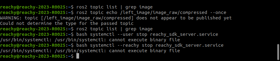

Could you check if you can see them with the following:
ros2 topic list | grep image
if yes, you can echo once of them to check if data is going through it with
ros2 topic echo /left_image/image_raw/compressed --once
Also, you could try to stop the sdk server service with
systemctl --user stop reachy_sdk_server.service
and use a script available to try to get the video feed from one of the camera:
python3 ~/reachy_ws/src/reachy_2023/camera_controllers/examples/view_cam.py left opencv
You can get more info directly in the documentation, in this section.

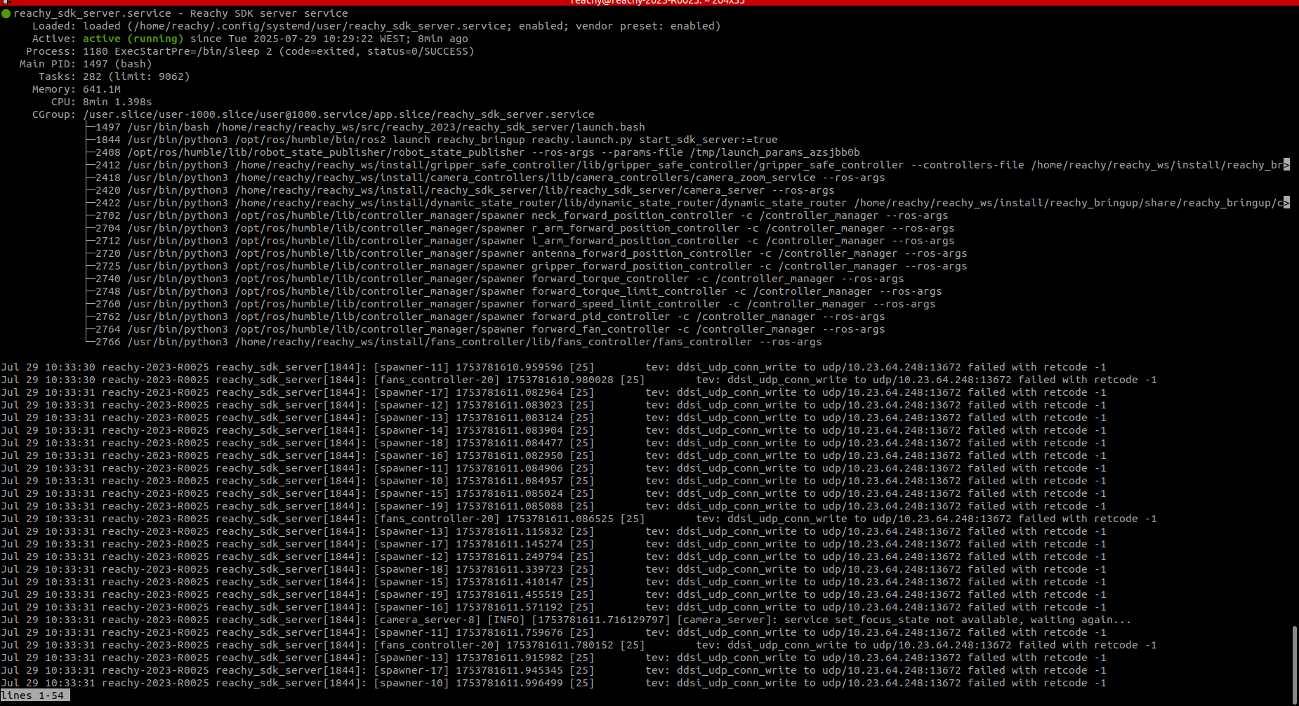

systemctl --user status reachy_sdk_server.service -n 10000 prints this:
and these are the logs for the commands
Ok, so the message tev: ddsi_udp_conn_write to udp … failed with retcode -1 usually means that there was a network error during usage. ROS’ DDS does not like network events such as changing wifi, losing wifi or ethernet connection.
When this happens, it is needed to restart the service, either in cli with systemctl --user restart reachy_sdk_server.service or by using the dashboard which should be running on the robot.
What is your network setup for the robot? Is it connected with ethernet, wifi, both? Is it on an academic network? Some users had issue with robot connected to faculty network due to firewalls or other safety added to the network.
The set up in those photos were on an acedemic wifi so i could access this forum and copy commands over. Usually it is connected to a wifi pineapple MARK VII router. When connected to to the pinapple router i haven’t had any issues with connectivity with moving arms/base, etc. The cameras arent accessible thru the network or when i am directly on the robot via a monitor/HDMI set up
