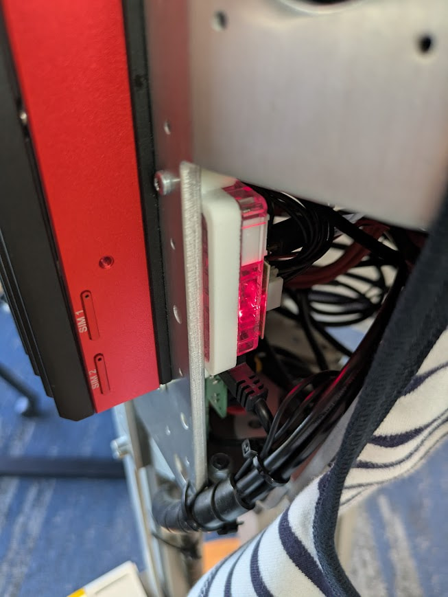

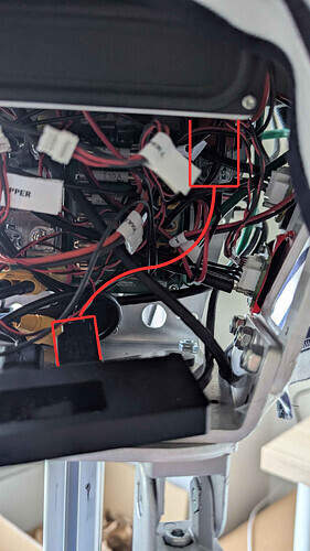

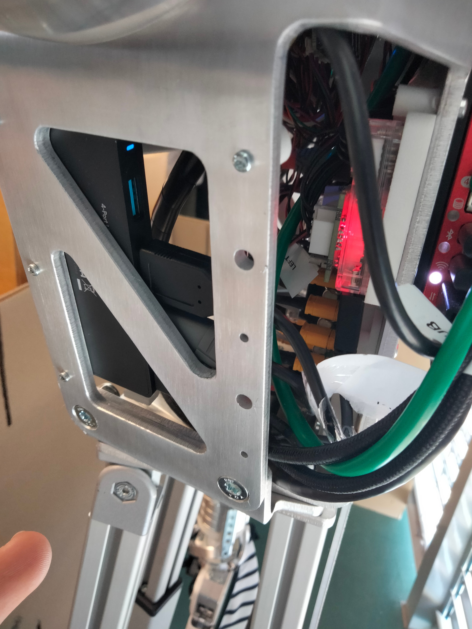

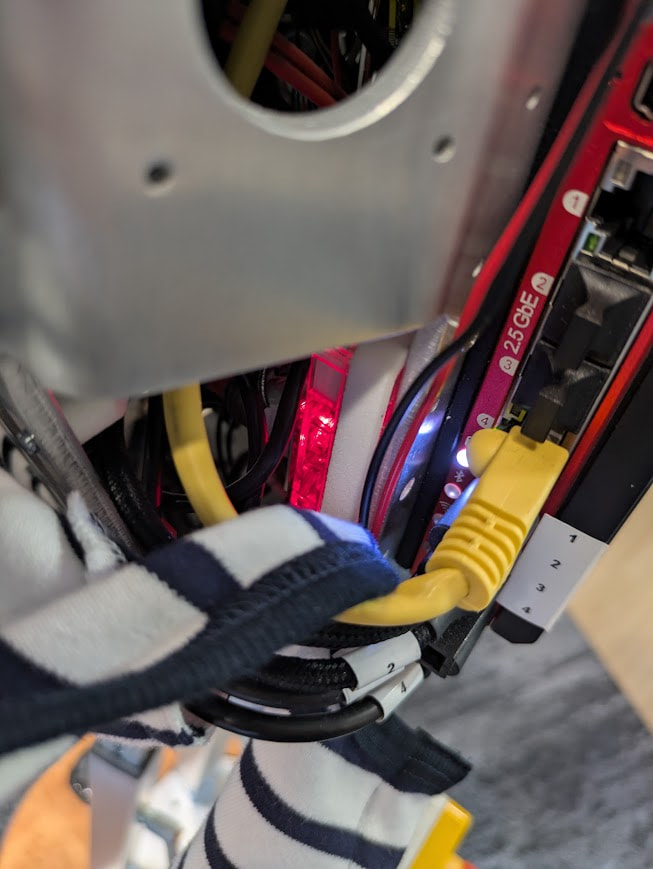

I also reseated the USB connections. The lights on both U2D2s appear to be red. (Images will be on a separate reply in this thread because I can only attach one at a time)
I haven’t yet tried changing the USB from the U2D2 from the hub but will as soon as I have a replacement cable!
